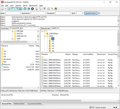

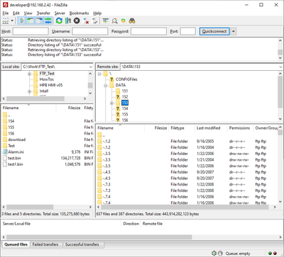

For some reason once I put more than 2GB of data in the Data folder the selected folder after 2GB returns invalid info about the files is in the folder. Each of the folder contain the same amount of data (1.09 GB) and the same exact files. Does anyone know what I need to do to fix this?

That is a  no go. The files you sent me match the files. I think you didn't send me the files that fixed the problem. I believe you are correct that it is a MFS file system issue. The MFS file system code is using 32 bits for the address instead of 64 bits. Can you send me the code in mfs\source\generic and mfs\include. I will merge what I need.

This seems a MFS file system issue.
Could you please merge my attached source code and try it again?
