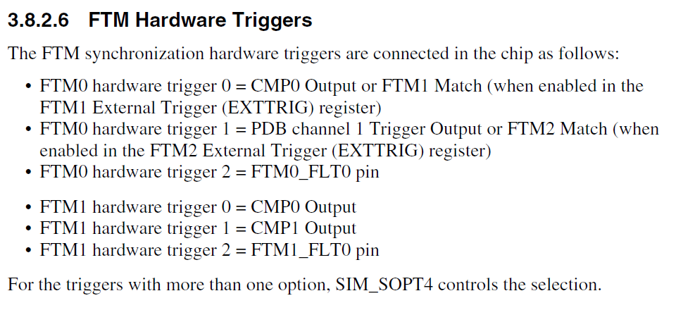

If you use hardware triggering, the Z pulse has to be connected to the FTM hardware triggering pin. I attach the FTM hardware triggering pin for K64:
The edge of Z pulse can reset the FTM_CNT register if you set the HWRSTCNT in FTMx_SYNCONF.
