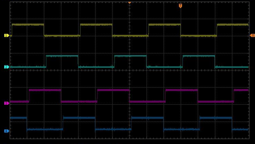

It generates 1kHz PWM 50% complimentary signals on PTC1, PTC2 and PTD4, PTD5, whereby the CH0,1 and CH4,5 are 45° phase shifted [binary attached]

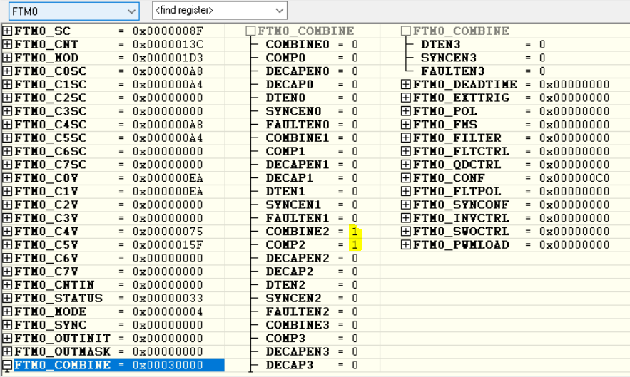

This is a snap-shot of the FTM0 registers so that you can compare with yours.
Note that to get complimentary outputs on a channel pair the COMP0 flag needs to be set. Since it is possible to do the non-shifted channels in non-combined mode I have set up the first 2 independently but one phase reversed (using MS_ELS_PWM_LOW_TRUE_PULSES channel setting instead) but could have used combined mode to do the same. CH4/5 (the ones you are interested in) are in combined/complimentary mode.

Thanks for quick response, i double checked all registers. Everything works perfectly fine but not the complimentary mode.
I compared values from your registers with mine, there are slight differences but nothing major except that i did not setup C5SC and C5V( but any attempt on changing values there end up with dead output)
I got COMP2 set in FTM0_COMBINE register but not COMBINE(is it required? i dont need to shift PWM or add deadtime at this point).
CH4 and CH5 still looks the same, CH5 not inverted. By the way is there a way to unpair channels?

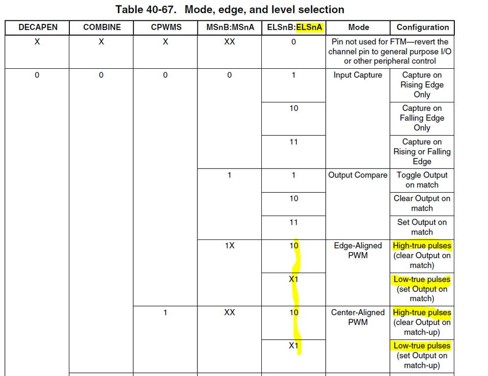

In case you don't actually need to pair the channels (not needed if not shifting or inserting dead-time, etc.) you can invert the output in its dedicated channel control register by using "Low-True Pulses" rather than "High-True Pulses":
This is what I explained as the way I did it on the first two channels; whilst I showed the COMBINE method on the second two channels (which are then paired) and can be phase shifted.
Note that the 0xa4 has inverted output to 0xa8 due to the setting detailed in the user's manual's table. Change these bits in the channel you want to have inverted and then it will probably work.
