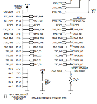

All CLKOUT pin possibilities are used for other system functions and have already been routed on the PCB making it difficult to isolate a likely candidate. I chose to reassign pin 58 on the 144pin LQFP K24 device from TRACE_CLKOUT to CLKOUT.
Using this pin allows connection of scope to the debug header which is easily accessible on our board. It does however disable the debugger so the status of the SIM_CLKDIV1 reg. must be determined before the pin reassignment.
