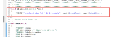

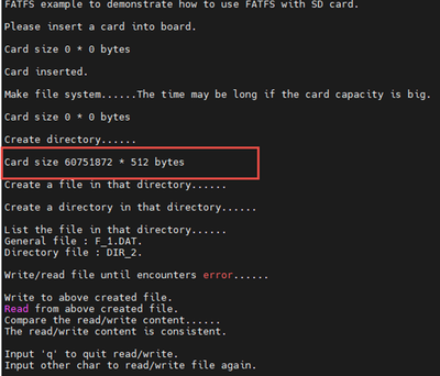

I used the MK66FN2M0xxx18 development board and the "frdmk66f_sdcard_fatfs" program in the SDK to conduct an experiment. At the same time, a 32G SD card was used in the experiment. My program can work normally and create files. I tried to modify the program to detect the size of the output SD card. The modified content and test results are shown in the figure below.
I also tested an 8G SD card and the program also worked successfully. I put the program in the attachment, I hope these can help you.

XuZhang, thanks for replying.  I tried your example code with a new 64GB microSD, and I got an error:
SEGGER J-Link GDB Server V7.96q - Terminal output channel
FATFS example to demonstrate how to use FATFS with SD card.
Please insert a card into board.
Card inserted.
Make file system......The time may be long if the card capacity is big.
Make file system failed.
Out of curiosity, I tried a different FRDMK66 board - I have two - and with the newer FRDMK66 board, the example code worked like yours with a 64GB microSD.  So it's partly a hardware issue.  I can live with that, since the older FRDMK66 will be used in a harsh environment, and a 2GB SD card should work well enough.
