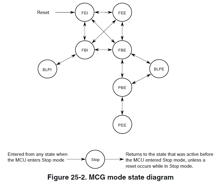

Hi.
I'd like to move my frdmk22 board, to PEE clock mode but I can't see different clock even changing values
in the below code.
Do I forget something ? Or ther's something wrong in my code ?
Thanks in advance...
Claudio
void PEE_InitMode(void)
    MCG->C2 = 0x2C;
    MCG->C1 = 0x98;
    while ((MCG->S & MCG_S_OSCINIT0_MASK) == 1)    ;
    while ((MCG->S & MCG_S_IREFST_MASK) == 0);
    while ((MCG->S & MCG_S_CLKST(10)) == 0x10);
    MCG->C5 = 0x03;  // /4
    MCG->C6 = 0x41;  // *25
    while ((MCG->S & MCG_S_PLLST_MASK) == 1);
    while ((MCG->S & MCG_S_LOCK0_MASK) == 1);
    MCG->C1 = 0x01;
    while ((MCG->S & MCG_S_CLKST(01)) == 0x01);
    SIM->SOPT2 |= SIM_SOPT2_PLLFLLSEL_MASK;
1,834 Views
kerryzhou
Hi Claudio Brunelli,
   Enable the PEE mode need to follow this diagram.
I use the KDS PE create a project which is configuring the PEE mode,
I attach the project for your reference.
Kerry

kerryzhou
Hi Claudio,
   PE code is just for your reference, you can don't use it, but just follow the code process write your own code.
Kerry
