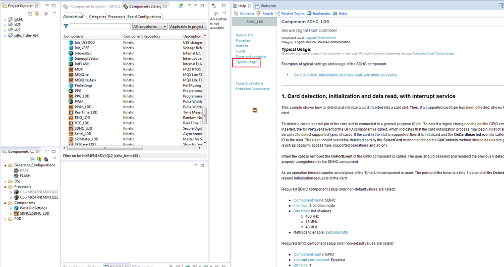

I think you can refer to the "Typical Usage" , there is demo code .
Please right click the SDHC component , then select the "help on component " , then you can find it :
Hope it helps

Thank you for your answer. Unfortunately, if it were that simple I would not have posted... The example does not work for me, failing (as I said in my post) at the GetCardInfo command. The project is a clean test of the component, with nothing else except what appears in the typical usage code.

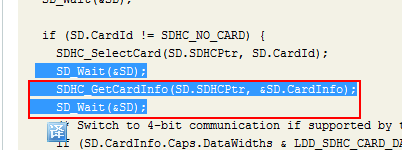

I checked in the demo code , there is a wait for the SDHC_GetCardInfo() :
Alice
2,947 Views
eyaldoron
Hello Alice.
I know there is a wait. It doesn’t help, it exists on a timeout. If I disable the timeout it waits forever.
