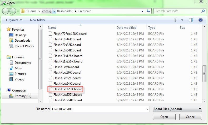

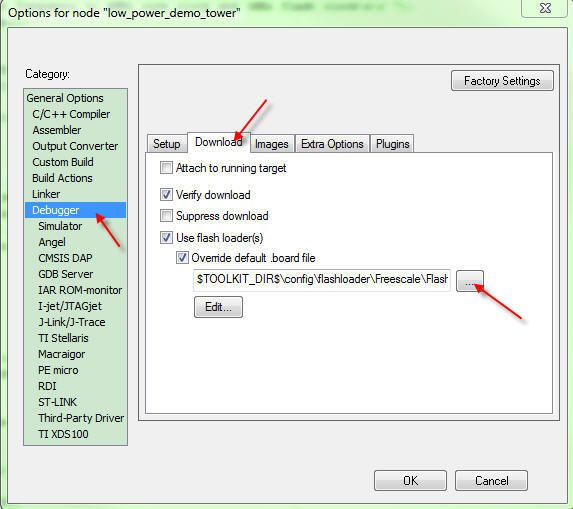

jeremyzhou
Hi Kai,
I suggest you can select another board file, so follow the figures show below to choose FlashKLxx128K.board.

My .board file setup is:
$TOOLKIT_DIR$\config\flashloader\Freescale\FlashKLxx128K.board
Which is exactly same file. However I specify it again (with same file). The warning dismissed anyway. Is it a bug of IAR?
