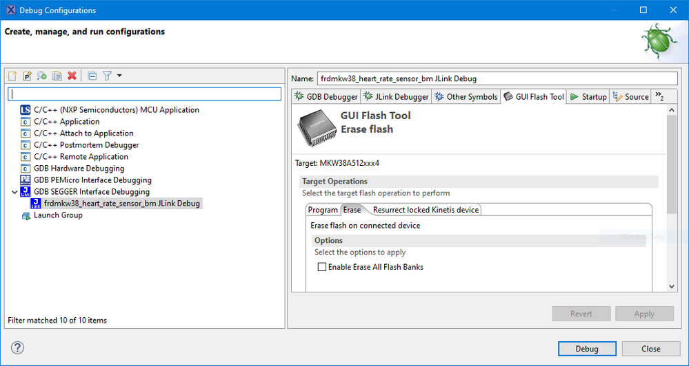

Hello everyone,
I have a the FRDM-KW38 development board. I tried to flash the HRS example from the MCUXpresso SDK to play with BLE. In source/app_preinclude.h, I disabled the PowerDown feature:
/* Enable/Disable PowerDown functionality in PwrLib */
#define cPWR_UsePowerDownMode           0
Stepping into the program shows a raised Hard Fault exception when trying to access FREESCALE_PROD_DATA memory region:
Screenshot from 2021-09-06 15-24-19.pngScreenshot from 2021-09-06 15-24-19.png
Below is my current memory mapping:
Screenshot from 2021-09-06 15-31-51.pngScreenshot from 2021-09-06 15-31-51.png
Someone ran into the same problem here but for the mkw36 development board: https://community.nxp.com/t5/Wireless-Connectivity/Hardfault-when-using-eeprom-in-KW36-BLE-demo/m-p/...
However I can't understand the solution as I don't have any prior experience with MCUs ='( I need a step-by-step guide to get this example up and running.
I'm a GNU/Linux user, I have installed MCUXpresso IDE along with the SDK (2.6.11) I connected the board using USB and followed instruction at https://www.nxp.com/document/guide/getting-started-with-the-frdm-kw38:GS-FRDM-KW38
Many thanks!
3,717 Views
nxf56274
1 Do you modify any other code except the 'cPWR_UsePowerDownMode' ?
2 Does this happen in the other example?
3 Use GUI flash to do Mass erase.  

Thank you for your answer, and I appologize for my later response.
No.
Yes. My focus is in BLE examples. So, I tested Beacon and peripheral with extended advertising. All with the same issue.
So sweet =O  It solved my problem many thanks. I didn't have the same option as you on my IDE (v11.4.0) both on Windows and GNU/Linux. So I did erase all flash banks (see capture below) and it worked after flashing the HRS example from the SDK (without any edit). Holding the SW3 made my board starts advertising.
