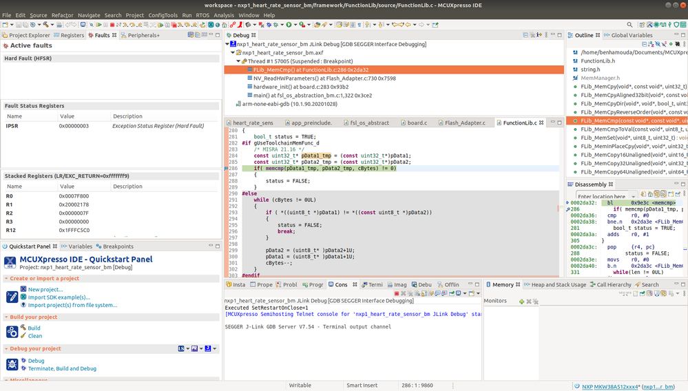

Stepping into the program shows a raised Hard Fault exception when trying to access FREESCALE_PROD_DATA memory region:
Screenshot from 2021-09-06 15-24-19.pngScreenshot from 2021-09-06 15-24-19.png

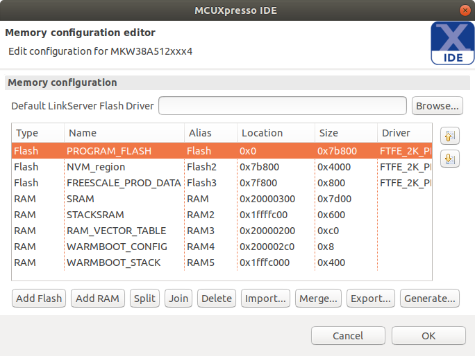

Below is my current memory mapping:
Screenshot from 2021-09-06 15-31-51.pngScreenshot from 2021-09-06 15-31-51.png

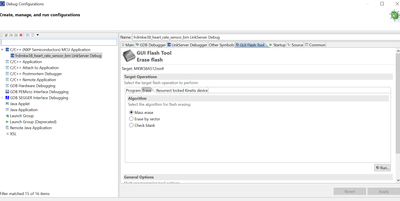

1 Do you modify any other code except the 'cPWR_UsePowerDownMode' ?
2 Does this happen in the other example?
3 Use GUI flash to do Mass erase.  

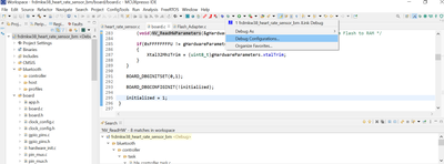

So sweet =O  It solved my problem many thanks. I didn't have the same option as you on my IDE (v11.4.0) both on Windows and GNU/Linux. So I did erase all flash banks (see capture below) and it worked after flashing the HRS example from the SDK (without any edit). Holding the SW3 made my board starts advertising.
