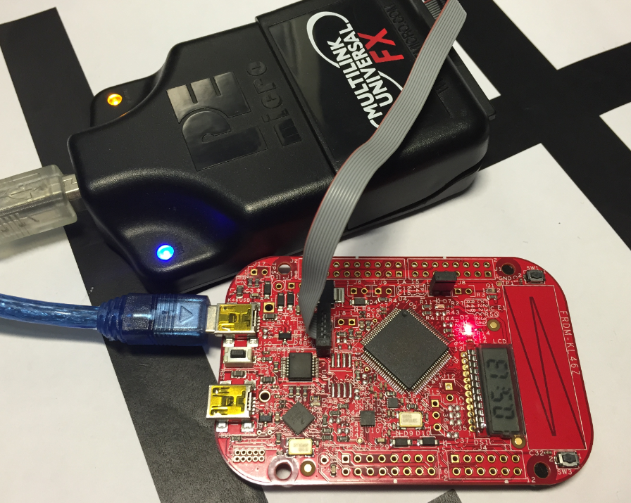

BlackNight
Neil,
you can debug it with the default jumper settings:
Powering the board should work with either USB port, but that depends on the debug firmware sometimes. Best if you use the KL46Z one so the K20 OpenSDA device is not powered.
I hope this helps,
Erich

BlackNight
Hi Neil,
>>What do you mean by: " you can debug it with the default jumper settings:"?   Does this mean you didn't cut the trace on the bottom of the board J18?
By default, there is a trace under J18. And on the picture of my board that trace is still intact. That trace only needs to be cut if you want to use the FRDM-KL46Z board to debug *another* board.
For example see Using the Freescale Freedom (FRDM-KL43Z) to Debug other Boards | MCU on Eclipse
I hope this helps,
Erich

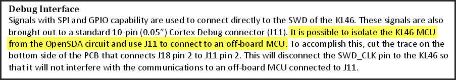

Now, what is troubling is that the schematic and User Guide are both saying cut the runner?????
Apparently someone didn't test this at Freescale and changed/upgraded documentation.
Regardless, thank you both for your help.
Neil

Jorge_Gonzalez
Hello Neil:
Good to know it worked!!
About documentation, just to clarify, this is what I found in the guide:
Using J11 to connect to an off-board MCU means using the OpenSDA for an external custom board or even other Freedom board, just like Erich himself has instructed in some of his tutorials:
Using FRDM-K64F Board to debug another Kinetis Board | MCU on Eclipse
Using the Freedom Board as SWD Programmer | MCU on Eclipse
You are doing the opposite, using J11 to connect to the on-board KL46 with an external tool (USB Multilink).
Regards!

Jorge_Gonzalez
Hello Neil Porven:
The jumper J18 must actually be placed, otherwise the SWD_CLK signal will not reach the KL46. That jumper should only be removed if you intend to use the on-board OpenSDA to program an external processor.
Please solder a jumper or shunt resistor and let us know if that works.
