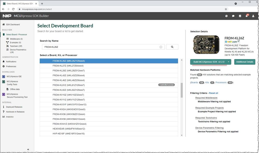

Please select FRDM-KL26Z and build the SDK_2.2.0_FRDM-KL26Z.
Then you can test the ADC examples.

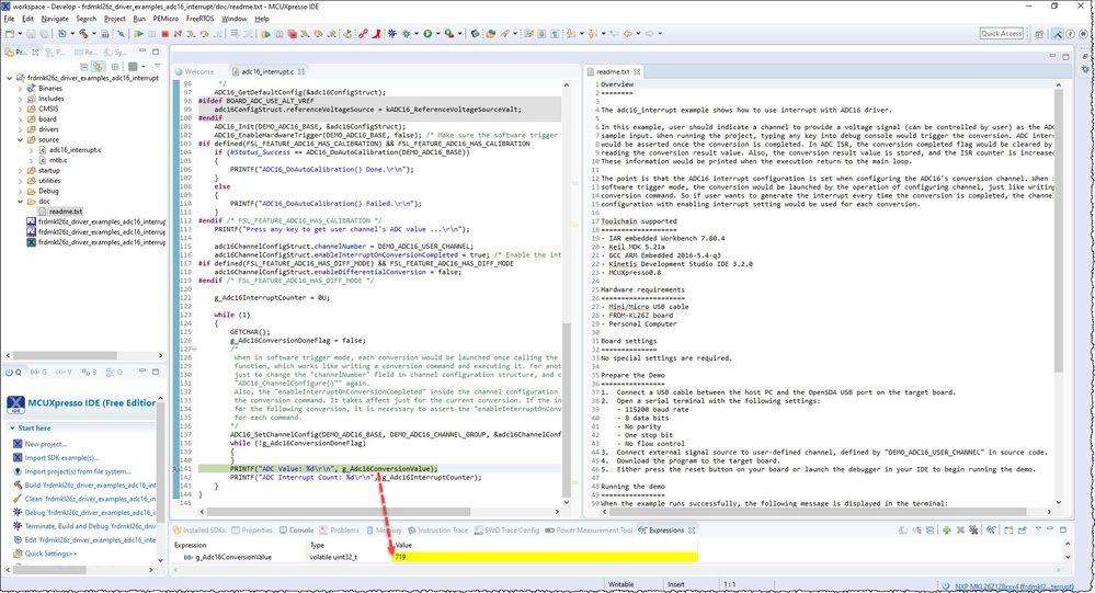

I have test the frdmkl26z_driver_examples_adc16_interrupt on FRDM-KL26Z, connect the ADC signal at pin11 J4.
I am able to get the ADC result below 1.05V.

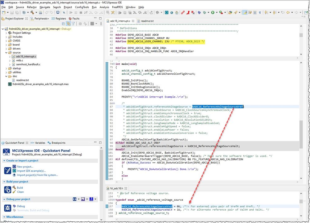

That example select kADC16_ReferenceVoltageSourceVref (external pins pair of VrefH and VrefL) as the ADC Reference voltage source.
If you have not modified the circuit of FRDM-KL26Z, the R10(0 ohm resistor) is connected by default.
Would you please measure the voltage of VREFH(Pin14) and ADC0_SE23(PTE30) by using multimeter?

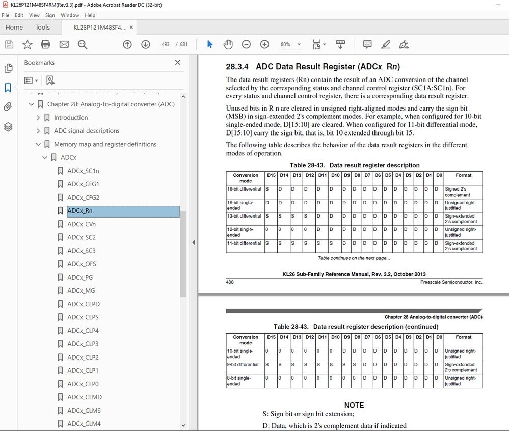

Why do you think the ADC result saturates at 1.05 V?
As the external voltage increases, does the value of the ADC data result register no longer increase?
What is the max value of ADC data result register?(tell me Conversion mode)
Maybe you can show me the value of registers during debug. And show the voltage value of the external signal measured by the multimeter.
