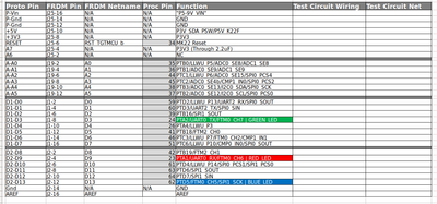

With the FRDM-K22F, which is what I tend to use for prototyping circuitry connections, I treat it like an Arduino and wire it to an Arduino prototyping shield.  This means that the inner rows of pins aren't available to me, but that's okay as it keeps me from trying to build too much into the circuit.
Using the schematic I created the attached spreadsheet (image shown) which simply lists the pins which come out to the Arduino shield.
I suggest that you try something like this, it really makes working with the Freedom boards easier.
