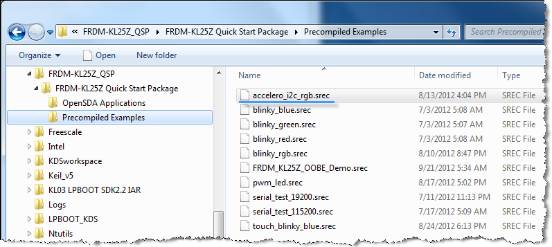

The color mix of the RGB LED should change based on the accelerometer data.

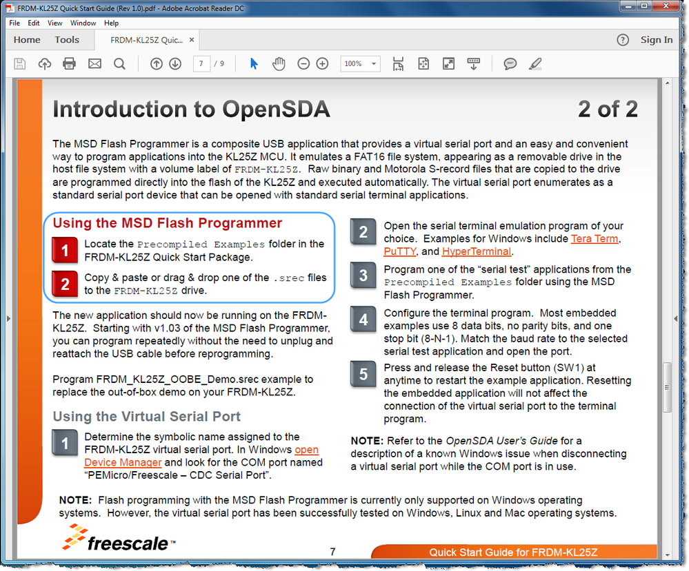

Please try to program accelero_i2c_rgb.srec example by using the MSD Flash Programmer.
You can find the accelero_i2c_rgb.srec after download the FRDM-KL25Z Quick start package.
