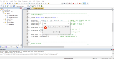

I'm a beginner. I'm trying to flash the example blink code to FRDM KL25Z board on Keil. But I'm getting this error "No debug unit device found" (Whereas I've plugged in my board to my laptop). Can anyone help me out with this ?

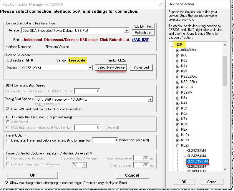

Alexa18
It says Port undetected as shown above. I tried disconnecting and reconnecting and refreshing, but it is still not working. Can you please make me understand what is causing the problem?

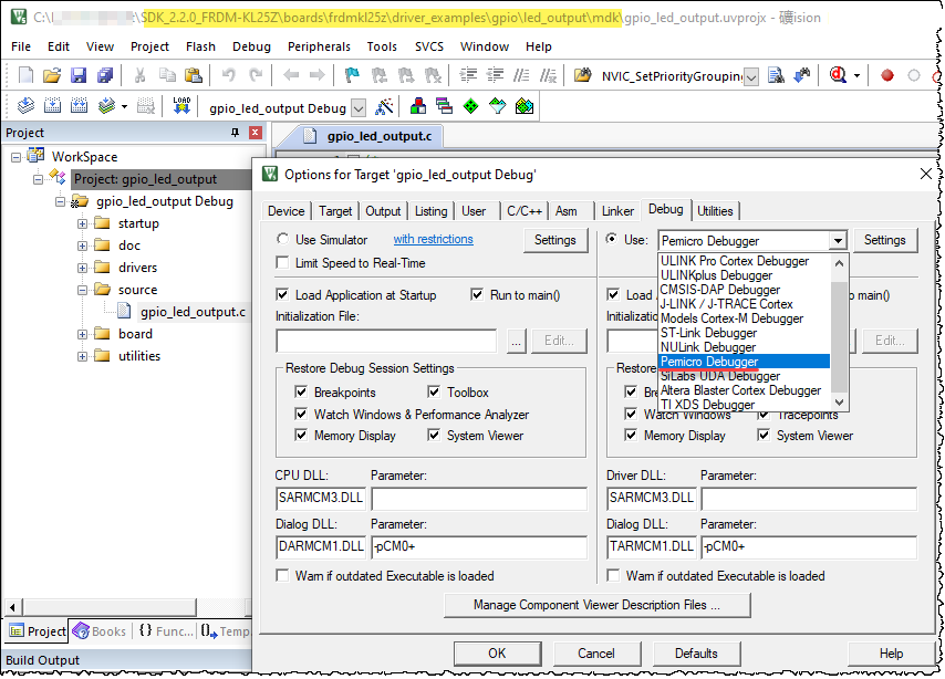

Robin_Shen
Hi Alexa,
The onboard debugger is PEMicro OpenSDA, so please select it and try to debug again.
You can getting started with MCUXpresso Software and Tools, there are a lots of Keil MDK project examples in MCUXpresso SDK.

Alexa18
I'm getting this error with that.
Also when I plug it in to my laptop, it doesn't appear as a storage device. An LED on the board blinks right when I connect it to my PC and goes off
7,114 Views
Robin_Shen
PE34298 is a known issue with old project that select Freesacle as Vendor. Please click Select New Device and chose NXP.
