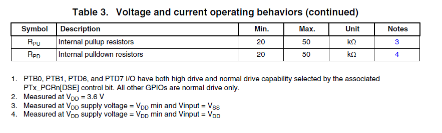

From user's manual:
Here I made a mistake since i looked at the enable control line, whereas they are in fact disabled out of reset.
From Data sheet:
Therefore enabling them  should give you 20..50k pull-up strength.
Since I don't use SDK I don't know whether it has an error or you are using it incorrectly, but this can be checked by reading back the PORTE_PCR3 register to check that it has 0x3 at the end (pull-up selected ad enabled).
