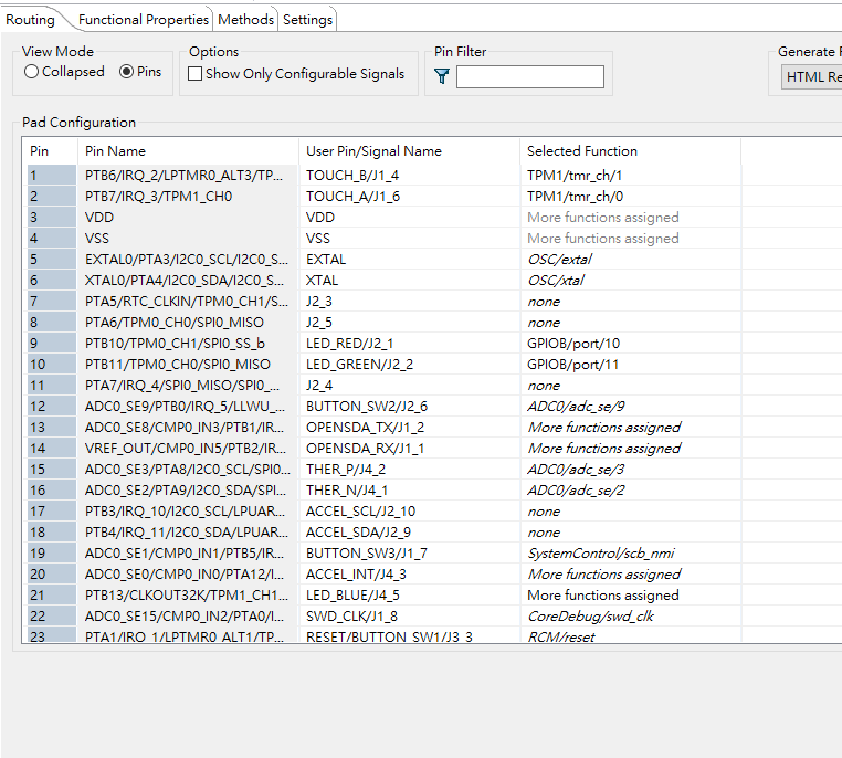

I have tried the TSI function and found so many way,then I realized the KL03Z couldn`t use source codes from KSDK,like KL02z & KL05z they don`t have the module for tsi  function but they do have Slider Pad.
So I searched for a while and I have a guess that using TPM combine ADC function, would it make? I have no ideal about build a new project in any method.
Down below is KL03z Pin mode
If there are any method or sample ,I`ll really appreciate.

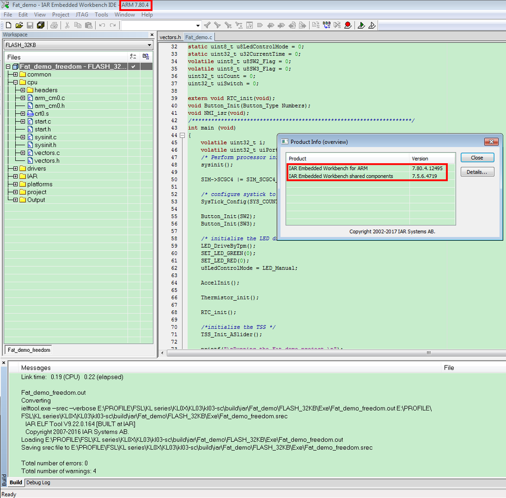

Hi Hans CHEN,
You can refer to attached code, navigate to fat_demo project, whic is the source code programmed to FRDM-Kl03Z
KL03Z don't have TSI module,here it use TSS lib to simulate TSI function by GPIO.
By the way: Maybe you should select one MCU which support hardware TSI.
Robin

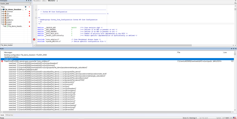

Hi Robin_Shen,
再麻煩您 過目

Robin_Shen
请使用老版本的IAR7.x
我在使用IAR8.x编译时也会遇到问题。

hans_chen
Hi Robin_Shen,
Thanks for your answer!
I found TSS Library and used with Codewarrior to build,but it only provide KL02Z and others without KL03Z.
So I tried to rebuild a new one based on KL02Z,but it still got some errors.
What should I notice or can you sample a process to me to refer?
That will be appreciate !
