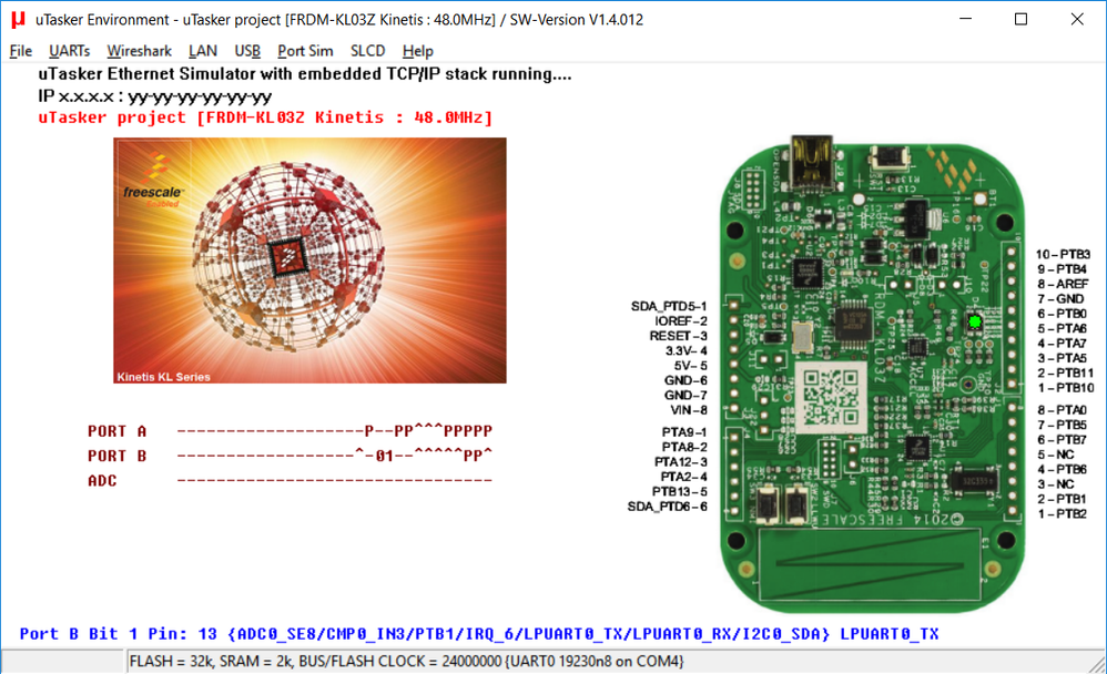

To clear the interrupt you need to write the 0x80 flag in the control and status register - however ensure to preserve the other bits since they define its operation.
Attached is the FlexTimer/TPM driver for the uTasker project as reference and the simulation below - D4 is a RGB LED so it is normal that it is green if the green element is lit.
To save time use the uTasker open source KL03 project since it includes everything you need, is documented and allows you to develop, test and debug much easier and faster in its KL03 simulator.
Full opens source code at http://www.utasker.com/forum/index.php?topic=1721.msg7086#msg7086
Mark
