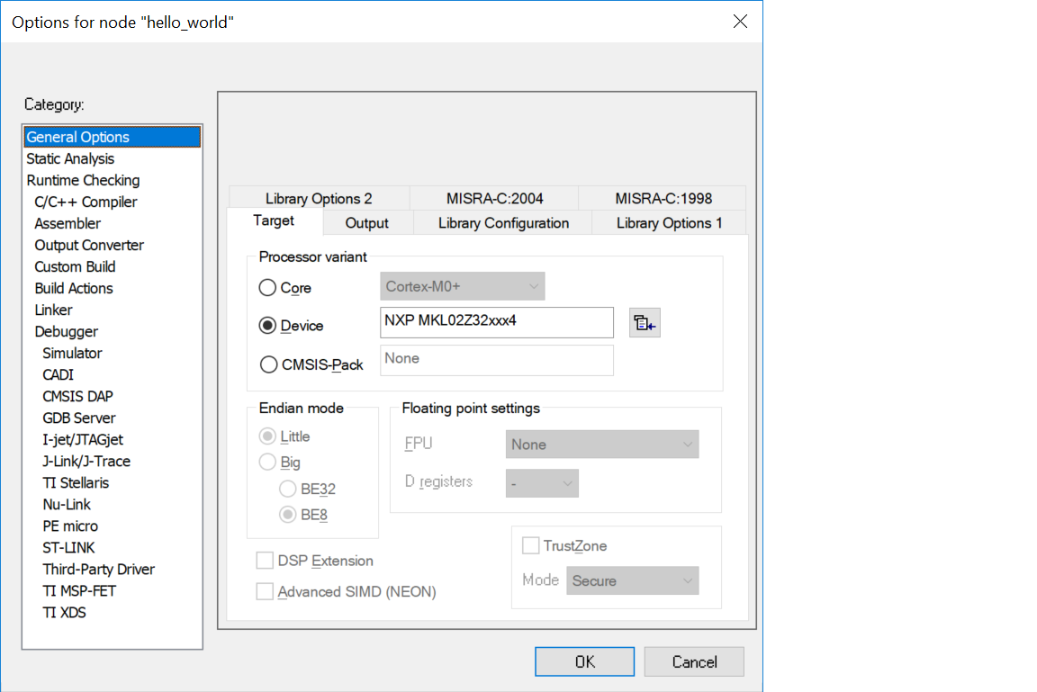

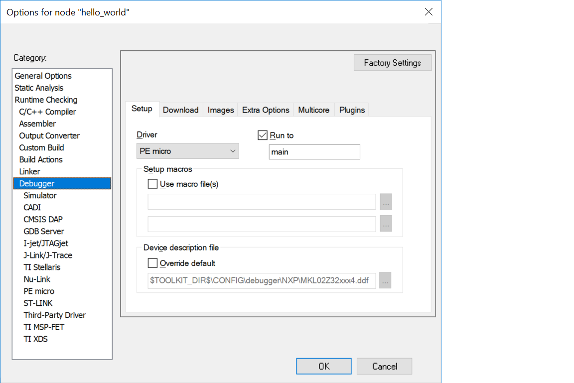

I'm using FRDM-KL02Z board, and IAR Embedded Workbench IDE - Arm 8.30.01. I'm trying to do the "Hello World" example but got the error below.  Can you please help me fix it?
I'm suspecting my settings for the Options are not correct.  I'm attaching my settings.  Any help would be appreciated.  Thanks.
Fatal Error[Li001]: could not open file "C:\Freescale\KSDK_1.3.0\lib\ksdk_platform_lib\iar\KL02Z4\debug\libksdk_platform.a" (failed opening file: The C:\Users\acle\AppData\Local\Temp\EW20BB.tmp 1
system cannot find the file specified.
: iostream stream error)

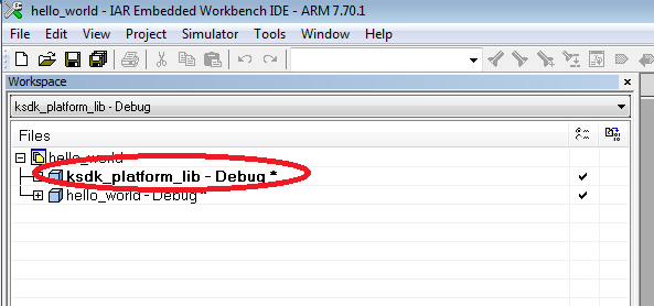

Hi Amy:
Did you compile the ksdk_platform_lib before you build the hello_world? the output is libksdk_platform.a
