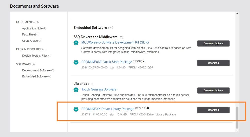

I am trying to run an SPI sample "SPI_MasterInt_demo" of the FRDM-KE06Z board.
I think a demo to send and receive, but where is the jumper pin connection of send-> receive described?
I'm not looking at the source code, so it would be helpful if I could explain it.
Also, is there a document that explains the connection and operation when running other sample drivers with FRDM-KE06Z?
Thank you.
