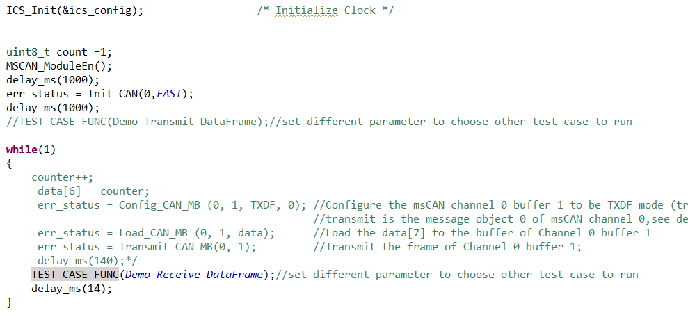

I am using FRDM-KEAZ128Q80 board  for my application and i need to communicate with CAN bus.
i got MSCAN driver code for KEA128 and i am using
TEST_CASE_FUNC(Demo_Transmit_DataFrame);//set different parameter to choose other test case to run
also its working fine and i am able to receive the data through CAN bus in another controller but problem is when i am calling TEST_CASE_FUNC(Demo_Transmit_DataFrame); for every 1 sec its going to sleep mode and it is working only time after that MSCAN is going into sleep mode so please anybody can help me out how to send data continuously  without going into sleep mode.
i attached my main file and MSCAN driver please find the attachment.

Test 'MSCAN_Driver+FRDM_KEA128 Example_TransmitPerSecond' example with S32DS on FRDM-KEAZ128 board. After connect Pin1 and Pin2 of J107 and then supply 12v power at J16, I can see the CAN data transmitted per second.
