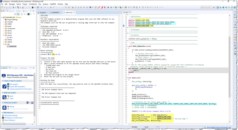

I have loaded the KBI example in MCUXpresso 11 for the Freedom Board KE06Z. However, it doesn't seem to work with the onboard switches on PTH3 and PTH4, butmaybe actually connected to H0?
I need to switch this over to using PTC0-7 and am unsure how to do that.
I've tried changing the port in #define EXAMPLE_KBI_SIGNAL_INPUT_REF_GPIO kGPIO_PORTH to
#define EXAMPLE_KBI_SIGNAL_INPUT_REF_GPIO kGPIO_PORTC but this doesn't work.
How do I switch from using port H to using all ports on PTC?
I'll also need to check to see which port triggered the interrupt.

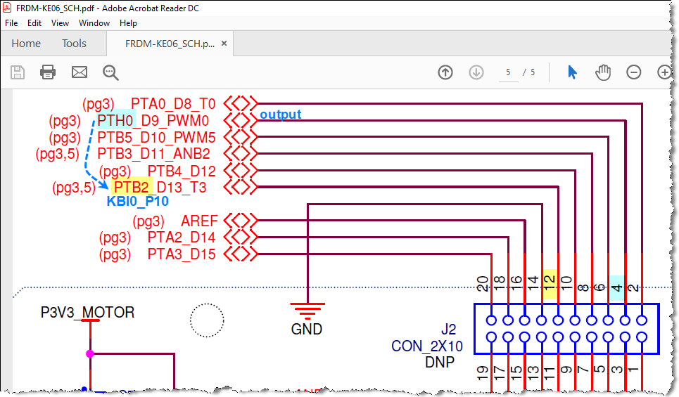

What you need to change is the definitions:
#define EXAMPLE_KBI KBI0
#define EXAMPLE_KBI_PINS (10)
This #define EXAMPLE_KBI_SIGNAL_INPUT_REF_GPIO kGPIO_PORTH is used to generate a signal trigger KBI0_P10.

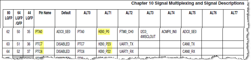

If you want to use the PTC7 as KBI function, then please change:
#define EXAMPLE_KBI_PINS (23)

Without looking at the example code I think that the main problem that you have is quite obvious due to the fact that the inputs on PTH and PTC are not controlled by the same KBI. If you just change the port reference you may be causing the code to configure the peripherals functions correctly on the ports but the original code will be configuring the wrong KBI (as noted above, PTH pins are controlled by KBI1 and PTC pins are controlled by KBI0, which means that you at least need also to change the KBI accessed in the example code - and probably also apply clocks correctly at different locations in the project code as well, plus configure and enter different interrupt vectors).
