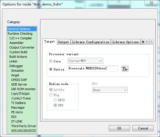

Hui_Ma
Hi Dave,
I don't meet your mentioned issue with FRDM-KE02Z board.
If you set the correct MKE02 device at IAR project options with below picture?
What is the IAR version you are using?
If it is possible, if you could post your project and I could test on my site?
Wish it helps.

davetelling
Hui_Ma,
Yes, I am selecting the correct processor in the project options. I am using the latest EWB version from the IAR website, 7.3. I have another FRDM board that I am going to try today and see if it makes any difference. So far, this only seems to happen with projects that use the timers. I will post my results.
