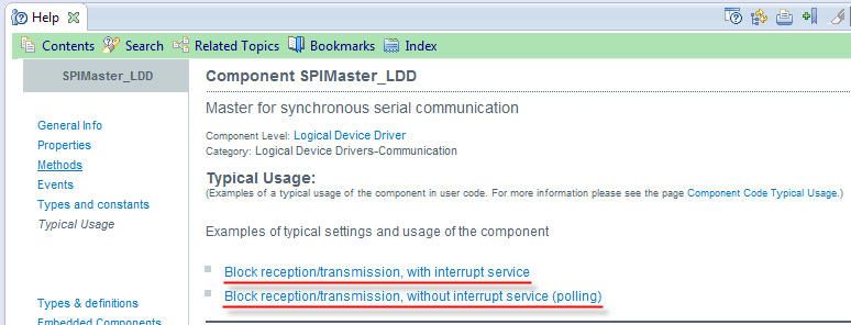

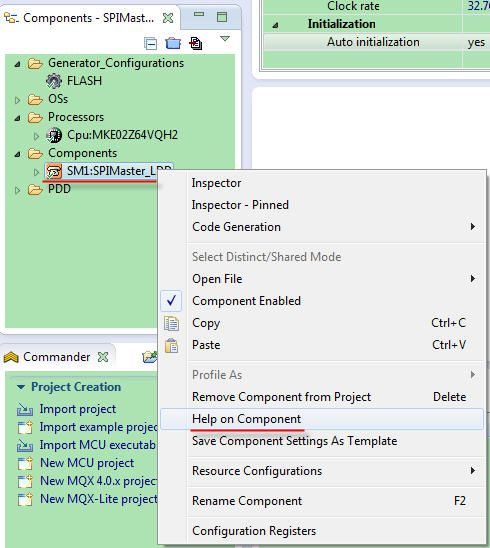

Robin_Shen
Have you read the Typical Usage of SPIMaster_LDD ?
There are two Typical Usage what can show you how to use this SPIMaster_LDD.
You just need to do according to them.
Hope that help.
Best Regards
Binbin
