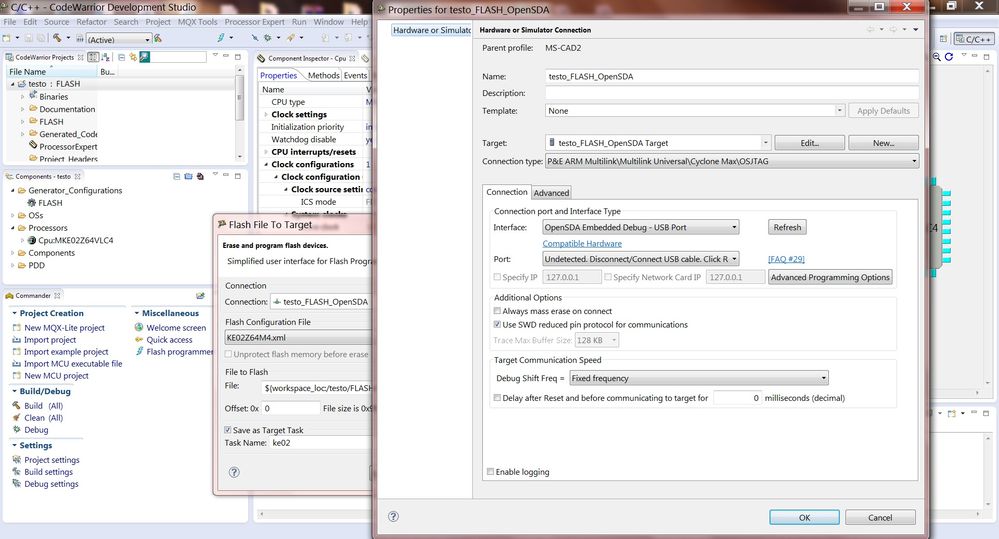

Yes, i can not flash, because when i plug board via usb-cable to PC, board starts always in debugging mode, button not pressed. It is clear that ,it is no possible flash when in debugging mode.
about project. Simple project created with ProcExpert. When i just get boards, the first time it worked but when I chose the wrong chip KE02Z64 - M4 instead KE02Z64 - M2 i think board  stopped working

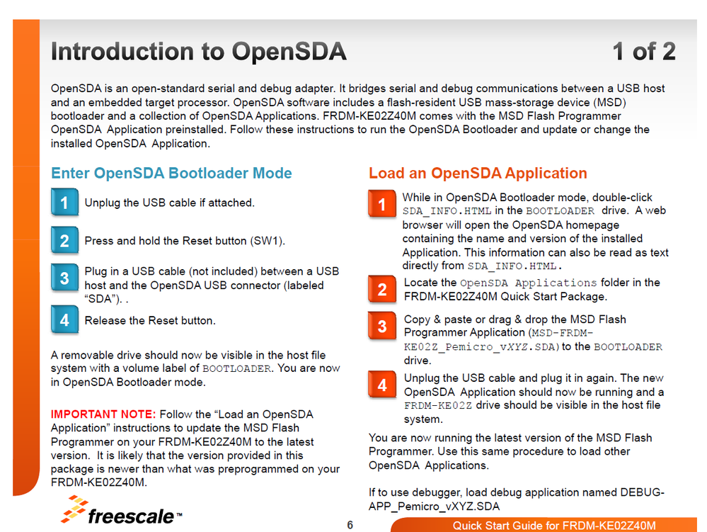

Fan_xy
Please update the bootloader , refer to the "FRDM-KE02Z40m_Quick_Start_Guide.pdf"
do as this , then test .

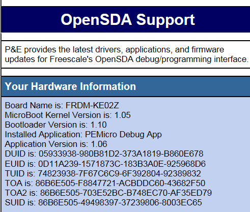

Hi Cit ,
The latest version is not always the right for all the board.
On my side , the version information as this :
and it can work well.
So please drag and past the "MSD-FRDMKE02Z_Pemicro_vXYZ.SDA" file to the bootloader.
and this file is under "FRDM-KE02Z40M Quick start package" (Freescale Freedom Development Platform for Ki|Freescale )

CitRam
it does not show an error, it always start from debugging mode, with green led blinking. reset button no pressed. It is clear, if it in debugging mode i can only open it as storage disk, i can see SDA_INFO.HTML and so on.
I have two board, one 20MHz version and one 40MHz
I think problem starts when i tried to flash with Flash Congiguration File KE02Z64M4.xml for 20MHz, and when i tried to check problem and select KE02Z64M2.xml for 40MHz i got some problem.
Please if you have 20MHz version, try to flash with KE02Z64M4.xml

Hi Cit,
1)  Press and hold the Reset button , plug in  USB, then copy and paste the "DEBUG-APP_Pemicro_v10.6.SDA"  (not the MSD-FRDM-KE02Z_Pemicro_v111.SDA )to the bootloader file.
2)  re-plug in USB, then test.
Alice
