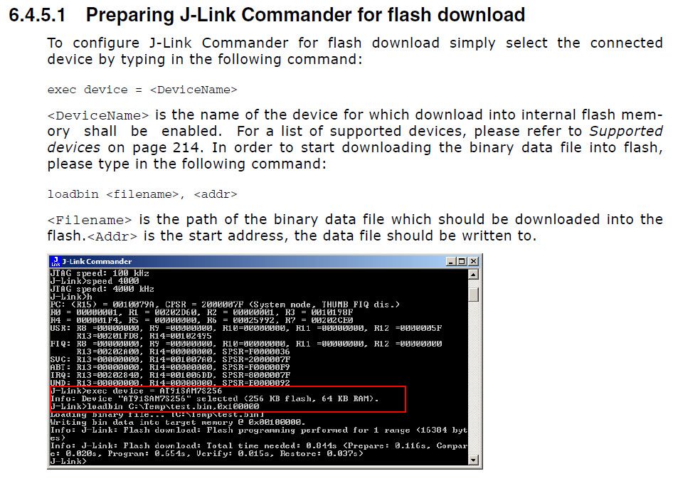

Mi FRDM-K82F quedó inservible después que lo conecté a WIN 10. Seguí las indicaciones del documento "Freedom OpenSDA Firmware Issues Reported on Windows 10", pero cuando trate de cargar el .bin (k20dx128_bootloader_0x5000.bin) reporta un error de apertura de archivo (fail to open file).
Qué puedo hacer para resolver este problema?

jeremyzhou
Hi Luis,
Before to execute the loadbin commander, you must assure the bin file already had been stored in the disk.
Then you can refer to the Fig 1 to use the commander.
Ping

Heron
Dear Jeremy,
the device is connected correctly, even Jlink did an erase task as you can see in the image I sent.
Now, and I'm asking again, Where is the "k20dx128_bootloader_0x5000.bin" file stored in the hard drive? What is the path to the .bin file on the HDD? I've searched the whole disk but it wasn't there.
Do I need to install more than just "Setup_JLink_V512e.exe"?
Or, Where can I download "k20dx128_bootloader_0x5000.bin" file?
