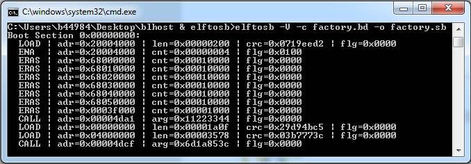

Hi Carlos,
I had changed the application linker script.
My elftosb screenshot is given below.
C:\Users\b44984\Desktop\blhost & elftosb>elftosb -V -c factory.bd -o factory.sb
creating encrypted range 0x68000000 len 0x3600
Boot Section 0x00000000:
LOAD | adr=0x20004000 | len=0x00000200 | crc=0x0719eed2 | flg=0x0000
ENA | adr=0x20004000 | cnt=0x00000004 | flg=0x0100
ERAS | adr=0x68000000 | cnt=0x00010000 | flg=0x0000
ERAS | adr=0x68010000 | cnt=0x00010000 | flg=0x0000
ERAS | adr=0x68020000 | cnt=0x00010000 | flg=0x0000
ERAS | adr=0x68030000 | cnt=0x00010000 | flg=0x0000
ERAS | adr=0x68040000 | cnt=0x00010000 | flg=0x0000
ERAS | adr=0x68050000 | cnt=0x00010000 | flg=0x0000
ERAS | adr=0x0003f000 | cnt=0x00001000 | flg=0x0000
CALL | adr=0x00004da1 | arg=0x11223344 | flg=0x0000
LOAD | adr=0x00000000 | len=0x00001a0f | crc=0x2f8e0c69 | flg=0x0000
LOAD | adr=0x68000000 | len=0x00003600 | crc=0xc4e54740 | flg=0x0000
CALL | adr=0x00004dcf | arg=0x6d1a853c | flg=0x0000

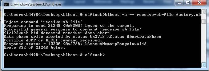

blhost output
C:\Users\b44984\Desktop\blhost & elftosb>blhost -u -- receive-sb-file factory.sb
Inject command 'receive-sb-file'
Preparing to send 21376 (0x5380) bytes to the target.
Successful generic response to command 'receive-sb-file'
(1/1)3%usb hid detected receiver data abort
Data phase write aborted by status 0x2712 kStatus_AbortDataPhase
Possible JUMP or RESET command received.
Response status = 10200 (0x27d8) kStatusMemoryRangeInvalid
Wrote 832 of 21376 bytes.

carlos_chavez
Hi Swaminathan,
Firstly, from a quick look at this question, the link that you attached appears to no longer exist and I do not have access to the "Payment Solutions QuadSPI XIP" package.  Also, I am not sure what you mean when you state that you could download code in Factory and programming mode.  What do you mean by this?
However, based on the error messages that you received:
According to the Kinetis blhost User's Guide, there is a note about the kStatus_AborDataPhase error.
Note that if the SB file contains a JUMP command, the receive-sb-file command is aborted at the point of the jump, and a status of kStatus_AbortDataPhase is returned.
For the kStatusMemoryRangeInvalid error message, I have seen that when attempting to use 'blhost' to download into QuadSPI alias memory space.  I do not have your 'factory.bd' file to confirm this, but are you loading directly into 0x0400_0000?  Based on the errata below found in https://www.nxp.com/docs/en/errata/KINETIS_K_1N03P.pdf, the ROM Bootloader does not recognize that memory space.
 e9626:   ROM Bootloader: Aliased QuadSPI address space is not supported by the Kinetis Bootloader command APIs
Description:
The Kinetis ROM Bootloader does not recognize QuadSPI alias space, starting at
0x0400_0000, as a valid address space. This means that API commands used to program
data into this space will not succeed, and attempts to boot directly to an address in the alias
space will return status error code ‘kStatus_OutOfRange'.
Workaround:
To program the alias memory space, use the normal QuadSPI address space starting at
address 0x6800_0000.
To begin executing code from the aliased space, the bootloader must first jump to the normal
QuadSPI address space starting at 0x6800_0000, or to internal Flash address space, and then
the code located in that address space should then jump to an address in the aliased space.
The SDK has an example of how to implement the workaround in the "hello_world_qspi_alias" demo apps.
