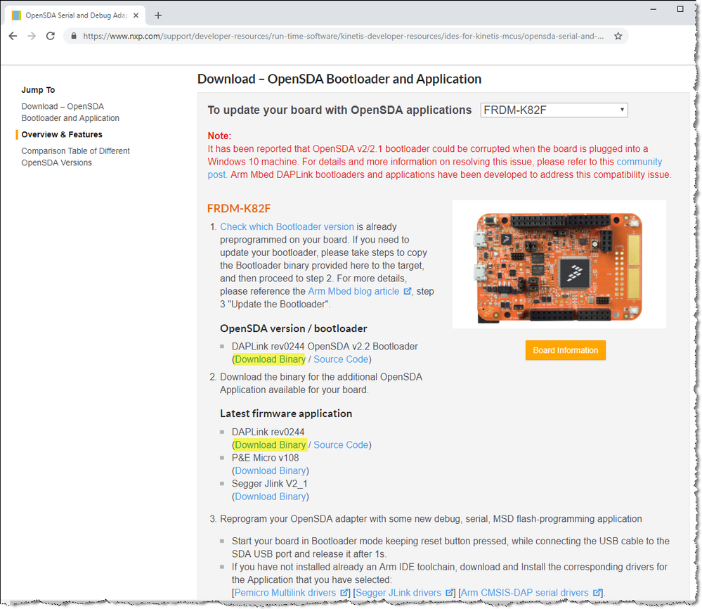

HI,
I am using FRDM-K82 board which has open SDA on board. I am unable to enter bootloader mode. I tried pressing the reset button and then powering it up. Still it is not working.
1,532 Views
Robin_Shen
It has been reported that OpenSDA v2/2.1 bootloader could be corrupted when the board is plugged int...

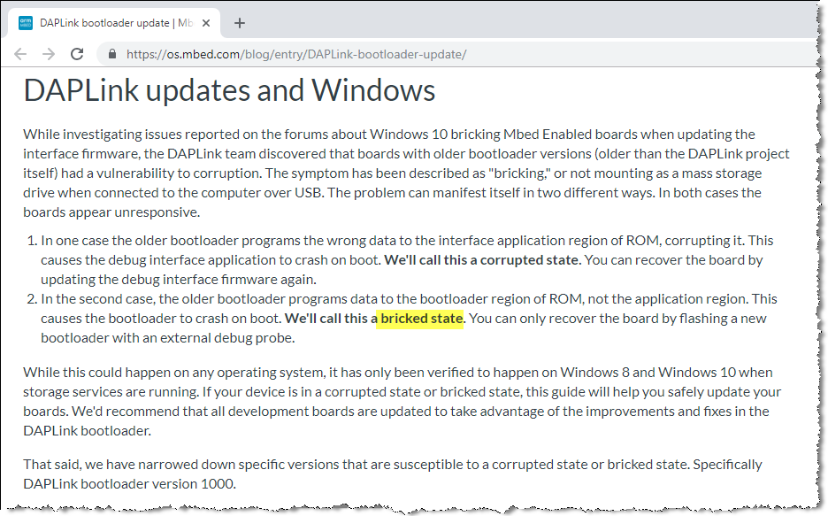

Please check if the your board is in bricked state.
If so please refer DAPLink bootloader updates with external debug probe to recover the bootloader.
