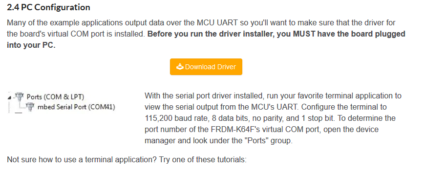

I faced the same issue on K64F and K66F freedom boards. The COM port was not found and the OpenSDA firmware update did crash the K20 with Windows 10.
Segger J-Link OpenSDA - Board-Specific Firmwares trick from Michael Cress solved it.
Could we change the driver download link from K64F and K66F get started page?
Thanks for your answer.
Paul
Get started link
Segger firmware solution
