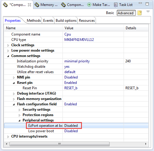

BlackNight
There is an option in the Processor Expert (CPU component) to disable EZPORT:
You could give that one a try.
Erich
5,450 Views
jasondark
I tried this.. it still would not solve the problem.
