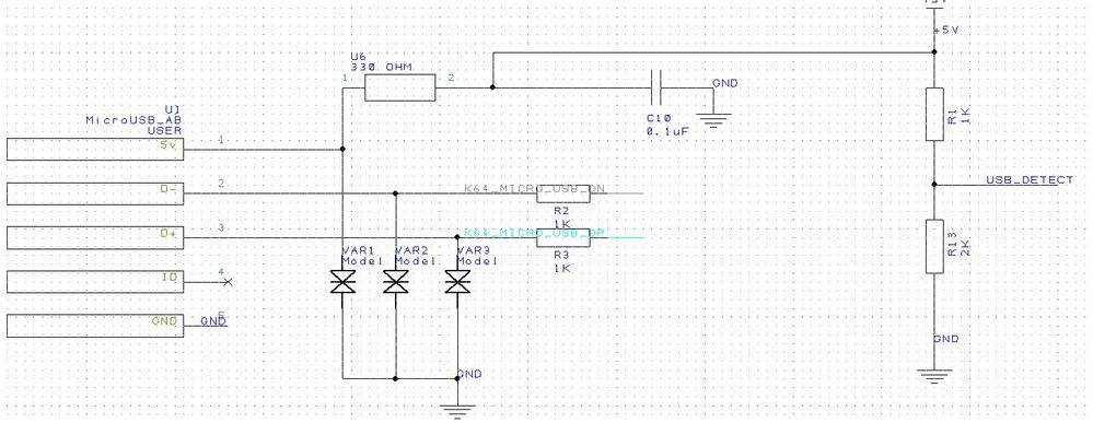

Hello all,
I have a problem with NMI too.
I connect this USB_DETECT to the GPIO used for NMI too x_x
When I boot my program by USB it works but if i disconnect USB to be powered by the battery I connected it falls in DEBUG_HALT (when NMI is not selected in configuration) or NMI_Interrupt (when I create it)
I would like not to fall in this interrupts. Someone has an idea?
Thanks to you :smileyhappy:

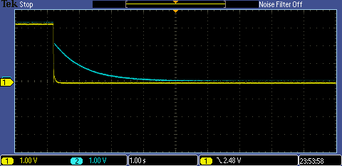

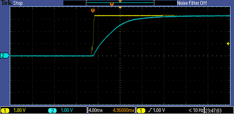

dean_jia
Now we can confirm this issue comes from  the “PTA4 /NMI/EZP_CS” pin. So I disabled the EzPort mode by clearing the EZPORT_DIS bit of FOPT, then the issue would not exist. And if only the NMI_DIS bit is cleared, the issue would not be fixed. Thus we can deduce chip enters EzPort mode when fails to startup.
The phenomenon of this issue can be explained as follows. when system is getting out from POR(power-on-reset), C55(between the pin and ground) is still charging and it’s voltage has not got to enough level, then chip will enter EzPort mode and not startup. If we power the board off and power on again in a short time, C55’s remained charge is still holding some voltage, ant then it can startup normally.
To testify this point, I captured the waveform of RESET pin and PTA4 pin during the power-on and power-off process, as shown in the following figures. The yellow waveform is for RESET pin and the blue one is for PTA4.
                                                power-on process
                                               power-off process
By the way, the parasitic capacitance of the oscilloprobe may have affect on the measuring result.
Now we can solve this problem by one of the following solutions: 1) pasting proper resister for R75 and proper capacitor for C55; 2) removing C55 directly; 3) disabling EzPort mode by clearing the EZPORT_DIS bit.
If the NMI is enabled, the NMI handler is also needed on the safe side.
Dean
