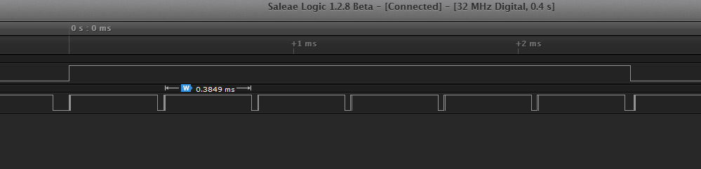

Well - there was one positive coming out of all of this work.
After my last post, I pondered at the timing.  I decided to look closer at how I was determining my baud settings.
I found a very big mistake .. all requested baud rates were producing setting of VERY VERY SLOW!!!
I redid my baud rate calculation and the timing is 10 times better now.
The closest I could get to 50Mhz was 40Mhz ... 120/3 is the closest ... wish it was faster.
So here is a SDHC clock at 40MHZ.
NOW -- complete 6 sector read is accomplished in 2.5 msec ... not the 220 msec reported earlier.
Also .. the only SDHC wait loop of any significance is waiting for the buffer to fill.  That time is now 383 usec compared to 32 msec reported earlier ...may not even do a task switch for that amount of time.
Thought I'd share my head up my ass finding.
Joe

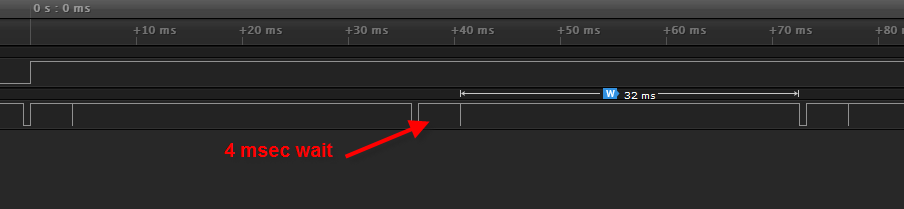

JHinkle
Senior Contributor I
One more timing picture ... Again CPU running at 120Mhz and SDHC running at 50Mhz
When the bottom timing line is LO -- cpu is executing -- when HI -- simply in a wait loop waiting on SDHC
It takes 4 millsec for the SDHC to return from a CMD17 command (read one block).
My watermark is set at 128, so I wait for the SDHC to fill the complete 512 byte buffer.  That simple wait loop is taking 32 millisecs.
From this, I can see how to implement task waiting from the RTOS and let other processes use that time.  Come back when the SDHC interrupt fires.
Just thought I's share while I trying to figure out the multi-block issue.
Joe

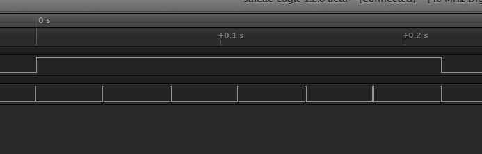

I did a timing capture of a 6 sector block read.
Please Note -- SDHC is running at 50Mhz.  Watermark is set at 512
The Top pulse shows the start/stop time of a loop of CMD17 commands --- 220 millisecs
The bottom small pulses show the actual time required to move the 512 bytes of data once it is in the SDHC's FIFO.
It also illustrates why the SDHC should be operated in association with a RTOS.  99.99% of the time, the cpu is waiting on the SDHC to finish it's task.  Perfect use of a thread waiting on an interrupt event to occur.
It also illustrates WHY I want to resolve this CMD18 (Multi-Block) read issue -- to reduce amount of SDHC processing time.
Joe
