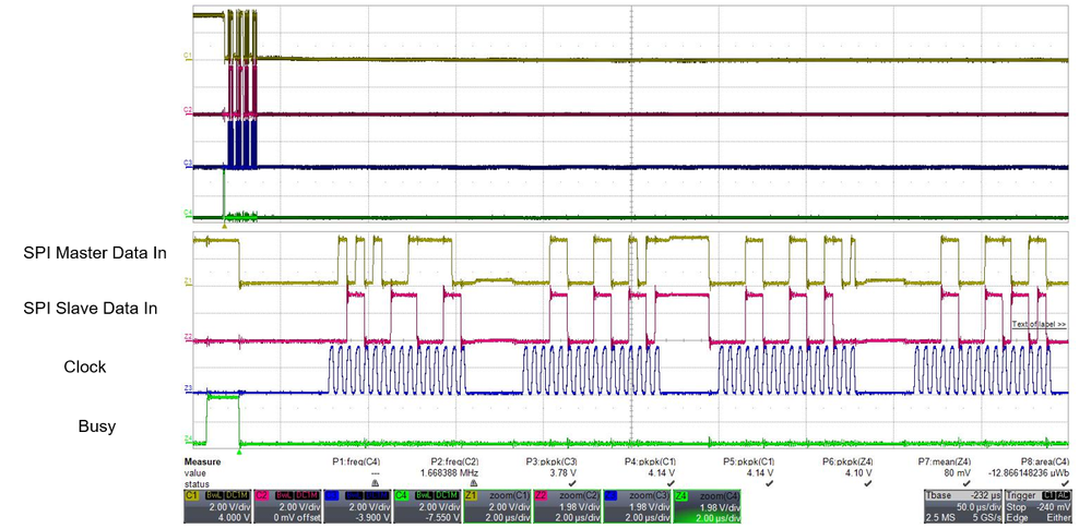

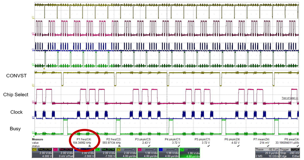

Thanks for your reply. Actually i was able to solve the problem. the code was working fine. i was able to get 104ksps.
i didn't connected the MOSI (FRDM) > SDI (ad7606b). after connecting them the slave was able to read the data as well. i am not using the MOSI as i am using hardware mode so i didn't connected it before. below are some captures.
below is the spi sampling speed capture
i have two more questions.
1) Is there a way to increase the sampling speed?
2) the 16bit data i received is right shifted for all 8 channels.
      ie  instead of     0010 1010 0011 1011
     i am getting        0001 0101 0001 1101
Regards.

GRK
Regards.
