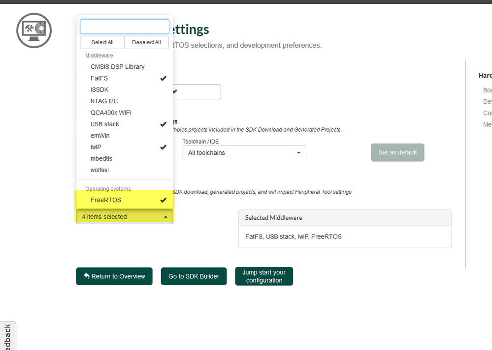

Has anyone a partial or complete Board Support Package for FreeRTOS. I have a maker project that I am developing with the FRDM-K64F. I have much of the RT tasks and inter-process communication completed, but development of BSP mapping is rather daunting.
1,538 Views
kerryzhou
Hi Robert Blazewicz,

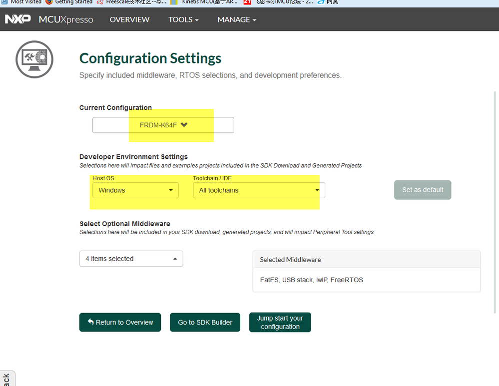

     About the FRDM-K64 BSP for FreeRTOS, you can refer to our K64 KSDK sample code which can be downloaded from this link:
Welcome to MCUXpresso | MCUXpresso Config Tools
   Click SDK Builder, then choose the board as FRDM-K64, then generate the code and download SDK_2.2_FRDM-K64F.
After download, you can find the FRDM-K64 freeRTOS code in folder: \SDK_2.2_FRDM-K64F\boards\frdmk64f\rtos_examples
Wish it helps you!
