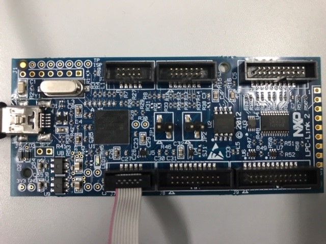

t-kira
Thank you for your reply.
The debugger I purchased this time is the one shown in the figure below.
I bought this debugger from the link provided.
The figure below shows the connection between the PC, debugger, and board.
The board connection is J10 pin.
We apologize for the inconvenience, but thank you for your reply.

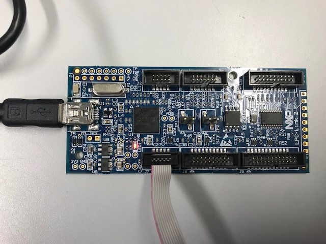

nxf56274
When you connect the debugger to PC, this led should light. I made a red circle. Please check.

t-kira
As you can see in the photo above, when you connect it to a PC, the LED lights up as shown in the figure below.
However, the same screen as last time is displayed.

nxf56274
Use a jumper to connect R46, I made a big red circle. 

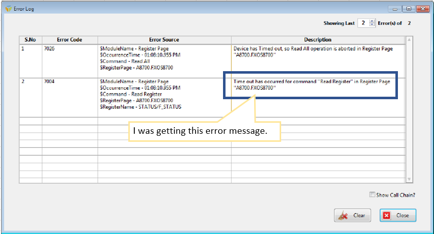

t-kira
Then, assuming that there is a hardware problem, I think the failure of the USB connector itself of FRDM-K64F-AGM01 is also possible.
In fact, after connecting the PC to the board for the first time after purchasing and starting The Freedom Sensor Toolbox-Community Edition (STB-CE), it was certainly recognized as "COM8" and I was able to proceed to the screen below.
 but,The error message of the next screen was displayed no matter what operation was performed from this screen.
So, I thought that there was a problem with the USB connector, and while checking the USB connection and disconnection, I started STB-CE and even COM8 no longer recognized.
Since that time, the phenomenon of what I asked has continued.
