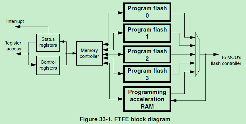

The K28 internal 2MB Flash consists 4 512-KB Program Flash blocks.
Below block diagram shows the detailed info:
What kind of partition application customer want to do with Flash?
Could you provide more detailed info about partition application? Thanks.

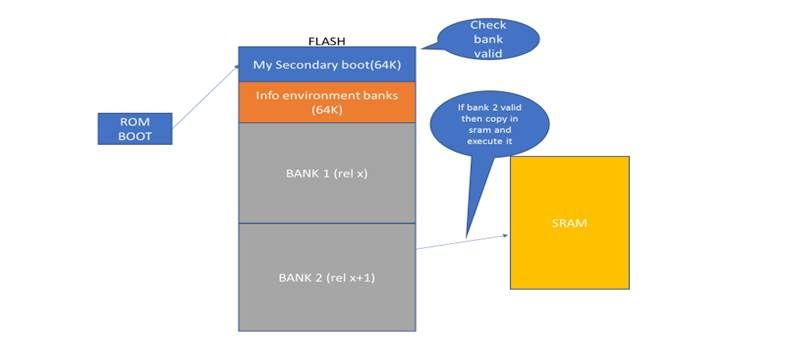

gianlucasofia
I try to explain better what I want to do.
I want to guarantee recovery in case of incorrect application software upgrade.
1) Start from standard boot and jump in FLASH (My Secondary Boot  first 64k of Flash)  .
2) My secondary boot read the info environment banks partition (second 64k flash ) to identifies which bank is valid.
3) if It find a valid bank then copy  my application in SRAM and execute it.
This behavior to guarantee the recovery a valid backup application after a software upgrade.
In fact I thought to use the non-active bank to download my new software. If new software does not start,  I can rollback on old software.
Is possible to partition the flash ?  For example : 4 partitions of  64k, 64k, 1010k, 1010k.
How can I do this? Any example?
Tks

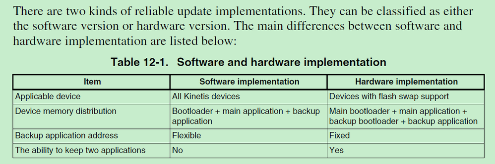

Hui_Ma
Thank you for the detailed info.
The K28 2MB flash with 4 physical blocks with 512KB each, which couldn't be partition to four different size.
About Bootloader reliable update, I would recommend customer to refer Kinetis Bootloader V2.0.0 reference manual chapter 12.
The K28 chip supports both kinds of reliable update implementation.
The detailed info, please check here.
Wish it helps.
Mike
