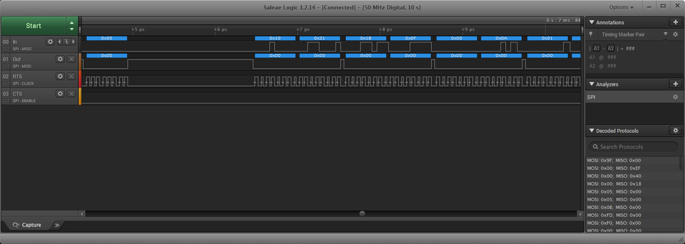

I'm using the K22F, but I think the SPI module is the same.  I use a mix of polled and DMA access.  I'm not using the SDK code, though - I was on Processor Expert before, but I've rewritten everything myself now.
I'm not sure about the current version, but previous SDK versions have had pretty heavy SPI drivers that imposed a lot of latency for small transfers.  I'm usually interfacing with SPI flash memory, and there's a lot of polling for completion and setting of write enable flags that requires some back-and-forth that can really slow down transactions.
For that stuff, I've got some very minimalist blocking functions for SPI access.  When a FreeRTOS task needs to read or write a block of data, it uses the DMA block read or write functions (after setting up the transaction in polled mode) so that other tasks can keep running while it waits.  I have one place where read/write access is needed in a critical section, and since there's no benefit to using DMA when you're just sitting and waiting anyway, it has a more complicated polling read/write that switches to 16-bit transfers to eliminate a wasted bit between words, so it gains a few percent in transfer speed over an 8-bit DMA transfer.
This is an old capture showing what I've been able to attain.  The big gap at +5 us is the switch between byte-at-a-time access and the 16-bit polled block transfer.  Note that there's still a 1-bit dead time between words, and I haven't found a way to get rid of that.
