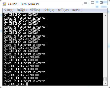

I'm interested about the output frequency of PIT(pit_frdmk22f). I run the project pit_frdmk22f, which is a frdmk22f board driving example. The pit_source_clock is at 40MHz, and the PIT_LDVAL0 is 100000U, and using digital oscilloscope read from port PTA1, shows the frequency is 10Hz.
When i set PIT_SetTimerPeriod(PIT, kPIT_Chnl_0, USEC_TO_COUNT(10000U, PIT_SOURCE_CLOCK)), the digital oscilloscope shows 100Hz.
When i set PIT_SetTimerPeriod(PIT, kPIT_Chnl_0, USEC_TO_COUNT(1000U, PIT_SOURCE_CLOCK)), the digital oscilloscope shows 250Hz.
When i set PIT_SetTimerPeriod(PIT, kPIT_Chnl_0, USEC_TO_COUNT(100U, PIT_SOURCE_CLOCK)), the digital oscilloscope shows 300Hz.
is the frequency  calculated by this PIT_SOURCE_CLOCK / PIT_LDVAL0?
#define PIT_SOURCE_CLOCK CLOCK_GetFreq(kCLOCK_BusClk)
#define PIT_CORE_CLOCK CLOCK_GetFreq(kCLOCK_CoreSysClk)
            PRINTF("\r\n PIT_SOURCE_CLOCK is: %d", PIT_SOURCE_CLOCK);
            PRINTF("\r\n PIT_CORE_CLOCK is: %d", PIT_CORE_CLOCK);

Additionally, it is worth mentioning that in the pit example there is a printf statement:
        if (true == pitIsrFlag)
            PRINTF("\r\n Channel No.0 interrupt is occured !");
            LED_TOGGLE();
            pitIsrFlag = false;
When the print statement is running, it limits the speed at which the GPIO can toggle. If you want to acheive higher speeds, it will be necessary to comment out or remove the print statement in this if statement. This should clear up your problem.

When i disable the print statement, the toggle frequency is much more higher.
