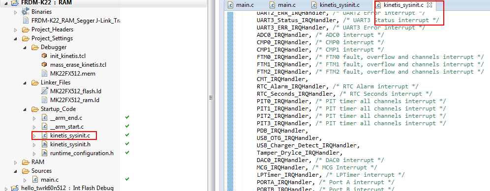

Hi Sasha,
In CW10.6, the interrupt vector is in the "kinetis_sysinit.c" file ,
the interrupt function name have been there , you can directly use .
And when enable the interrupt, when need write a enable function , like this :

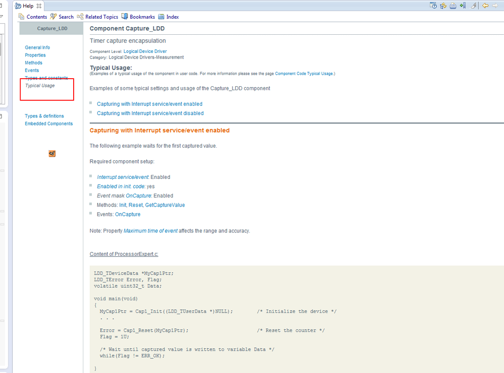

Hi Sasha,
I recommend you use the Processer Expert , "Capture_LDD" or "TimerInt_LDD " both are ok  .
After configuration the component , then generate code , you can see the init code .
And you can refer to the help on component , there have  input capture demo , in the "Typical Usage ".
The Processor Expert can directly generate code, if you do not want use it , you can refer to the generated code to write your own code.
