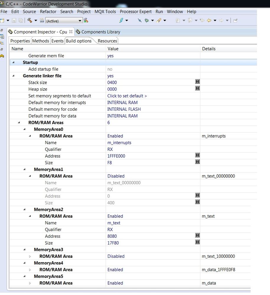

Good afternoon,
I'm testing the FRDM-K20D50M board. I flash it with USB Bootloader uTaskerSerialLoader_FRDM-K20D50M.S19.
I made a little code for blinking a led with Processor Expert:
while(1)
    LEDRED_ClrVal(NULL);
    WAIT1_Waitms(250);
    LEDRED_SetVal(NULL);
    WAIT1_Waitms(250);
The README file says :
"If you load your own application make sure that it has its reset code is linked to be at 0x8080. Interrupt vectors should be run from RAM or set to a
location in the code (not left at 0x00000000)" .
I have set the CPU component as in figure :
After the drag and drop of a program file the board does nothing, the led don't blink.
The Output File Format is ".SREC" .
A normal program with "Default memory for Interrupts"=INTERNAL FLASH, and address=0x00000000 works fine with blinking led.
There is something wrong. I attached the project.
Thanks to whoever can help me.
Jerry

MEMORY {
  m_interrupts   (RX): ORIGIN = 0x00008080,  LENGTH = 0x000000F8
  m_text           (RX) : ORIGIN = 0x00008410,  LENGTH = 0x00017BF0
  m_data         (RW) : ORIGIN= 0x1FFFE000, LENGTH = 0x00002000
  m_cfmprotrom(RX) : ORIGIN= 0x00008400,  LENGTH = 0x00000010
These should be about right. However m_cfmprotrom() is not used (the boot loader defines the flash configuration and the application can't).
m_interrupts() only needs to be 0x08 in length if the reset vector is there - with 0xf8 all interrupt vectors are probably being located. If this is done the application needs to set the Cortex VECTOR_TABLE_OFFSET_REG to point to 0x8080 rather than 0x00000000.
Mark

If you are using the USB-MSD (drag-and-drop) you need to drag and drop a binary file and not an SREC.
In addition, at the address 0x00008080 you need to have the reset vector that would normally be at 0x00000000. Looking in your SREC file this is missing.
Compare your SREC (or binary) with the reference - in the reference it starts with
S30D00008080FC7F002049B100005D
which means that there is the value 0x20007ffc at 0x00008080 and 0x0000b149 at 0x00008084.
0x20007ffc is the initial stack point (it will be loaded to the SP when jumping to the application) and 0x0000b149 is the initial program counter - it is where the application will be started. [this is the standard reset vector but shifted to a new location]
In your file I see S3150000808000BF00BF00BF7047002000BF00BF00BF99
which would be a SP of 0xbf00bf00 and PC of 0x4770bf00 which looks to be other program code or const data.
To summarise:
- SREC can be loaded by the serial interface but USB-MSD uses a binary instead.
- Your program doesn't have its reset vectors at the start location and so this needs first to be fixed. It is easy to monitor and see when it is correct (PC will match the start address of the program in the map file).
Mark

jerryfavero
Hi Mark,
it's possible to disable "Generate Linker file" in PE, thus to edit it manually.
Below some lines of a "normal application"linker file (attached file).
/* Generate a link error if heap and stack don't fit into RAM */
__heap_size = 0x00;                    /* required amount of heap  */
__stack_size = 0x0400;                 /* required amount of stack */
MEMORY {
  m_interrupts   (RX): ORIGIN = 0x00000000,  LENGTH = 0x000000F8
  m_text           (RX) : ORIGIN = 0x00000410,  LENGTH = 0x0001FBF0
  m_cfmprotrom(RX) : ORIGIN= 0x00000400,  LENGTH = 0x00000010
May you help me to edit this file, to adapt for a utasker boot (the board is FRDM-K20D50M).

jerryfavero
Hi Mark,
now it works fine, also with timers interrupts.
1) I have disabled "Generate Linker file" in Build Option in PE, and edit it manually as your indication:
MEMORY {
  m_cfmprotrom  (RX) :  ORIGIN = 0x00008400, LENGTH   = 0x00000010
  m_data            (RW):  ORIGIN = 0x1FFFE000, LENGTH  = 0x00002000
2) In "User code after PE Initializzation" in Build Option I have added , that is visible after building in CPU.c file:
  // USER CODE AFTER PE INITIALIZATION
  uint32_t *pdst ;
  uint32_t *psrc;
  uint16_t  i ;
  // Copy Application Stored Interrupt Vector table to RAM
  pdst=(uint32_t*) (0x1FFFE000 );
  psrc=(uint32_t*)( 0x8080 );
  for (i=0;i<0xF8;i++,pdst++,psrc++)
  {        (*pdst) = (*psrc);
  // Then redirect the vector table to RAM by changing the SCB_VTOR like this:
  // Redirect the vector table to the new copy in RAM
  SCB_VTOR = (uint32_t)(0x1FFFE000);
Using only a MSD boot ,esist an easily mode to enlarge the application program (over 70K as writen in reademe file)  ?
