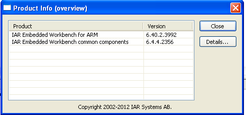

Kan_Li
Hi Stephen,
What is the IAR version that you are using? Actually it is complied successfully on my side with 11 warnings , Please kindly refer to following for details.
and this is my IAR version info:
Please try to use a same version IAR or even higher and try again.
Hope that helps,
Kan

stephenfranklin
Thanks for the help. I'm running 6.50.3.4757 at the moment, the error I get most is
[Og007]: Assembler list file generation not allowed in this version of the compiler
Error while running C/C++ Compiler
I reloaded the example code just to make sure that wasn't the problem but the error is the same. Looks like I don't have IAR loaded correctly but I don't know what I need. Is IAR the best way to go in learning the capabilities of this chip or is there something else that would work better? I'm comming from a simpler place as I have been using Atmel chips with AVR Studio and Arduino and the Parallax Propeller chip with it's IDE which are very specific to the chips used.
