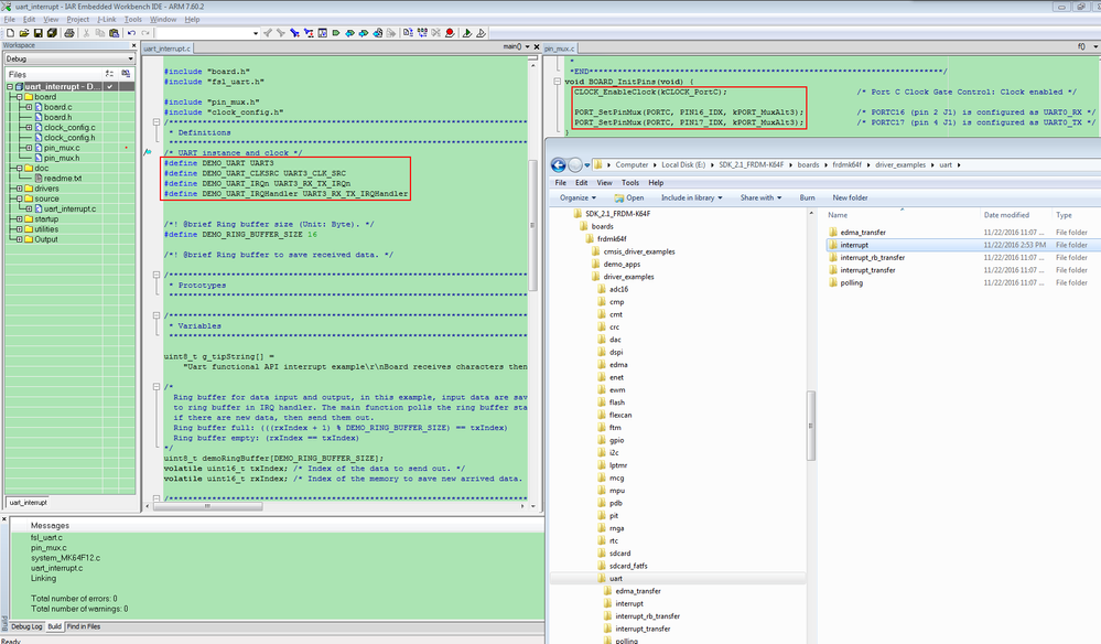

I'm using FRDM-64F board for my project.I need to get the UART receiving
data whenever it arrives on receive pin.I used UART3 PTC16 and PTC17 pins
for UART and KDS as IDE. I tried several interrupt configuration,which are
not working .Using UART_DRV_ReceiveData for reception which is also
interrupt controlled that also not working.Please help me for solving that
issue.Suggest any other pins, which is available on the board.
AJAY K R
1,282 Views
Robin_Shen
Hi AJAY K R,
You can build and download the SDK_2.1_FRDM-K64F from MCUXpresso Config Tools.
If you want to use UART3, please refer below image then change the codes.
