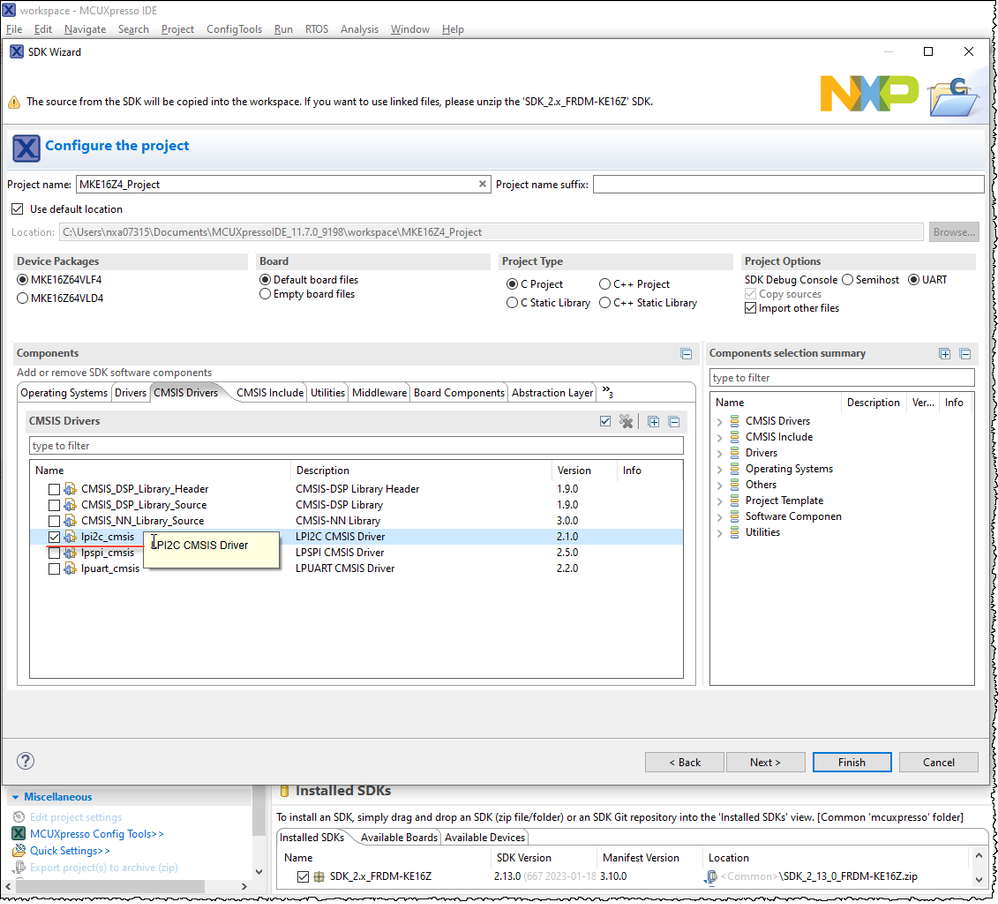

I made a new project based on FRDM 16KEZ SDK, and i included drivers from peripherals and config the pins and clocks. How i generate the RTE_Device.h? I see it suppose to be in board folder, but there are files generated from the pins, peripherals tools. Ty!
1,197 Views
Robin_Shen
Seems that you are refer to the frdmke16z_cmsis_lpi2c_int_b2b_transfer_master example. Please add LPI2C CMSIS Driver when you create new project.
lpi2c_cmsis LPI2C CMSIS Driver RTE_Device.pnglpi2c_cmsis LPI2C CMSIS Driver RTE_Device.png
