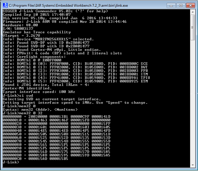

Hi Manuel,
I am able to successfully connect to my FRDM-K82F board via my J-Link probe via J19 by removing J6 and J7 jumpers.  Since J19 is not a keyed header, please make sure that you have the proper orientation for pin 1 and that your Cortex M Adapter is not offset.  As the pins are very small, it is quite easy to do.
Here is my output below:
So, just to make sure, you are able to communicate to the MCU using the J-Link OpenSDA App with the USB Micro cable connected to J5?
-Carlos
