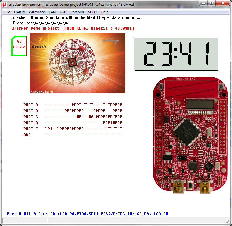

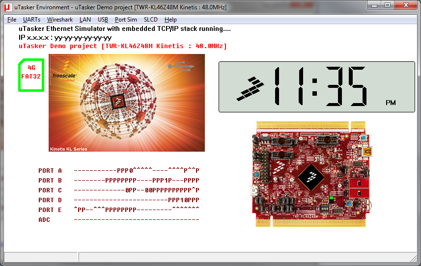

The KL46 is supported in the uTasker project (TWR-KL46 and FRDM-KL46 as immediate target builds) with utFAT on SD cards via the SPI (or uFileSystem in ATMEL 45DB xxx, SST25xxx or ST 25Pxxx serial flash). See below simulations of the two boards operating with SD card and driving SLCDs.
Mark
http://www.utasker.com/kinetis.html
