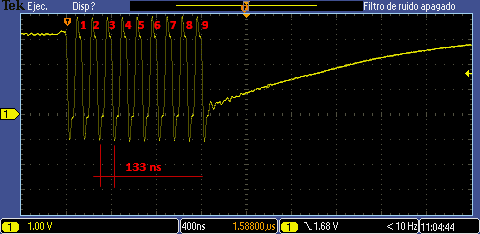

The example works fine when the PWM signal period is about 200ns or higher, but I need to generate a faster PWM signal. When the PWM is configured with a period of 133ns, using an oscilloscope I can see that after 8 rising egde the PWM signal is disabled. So I assume that it is working ok. However, sometimes it needs 9 pulses and some others 16 pulses to be finished. Please have a look to the scope images.
Does it mean that DMA can´t work so fast? I need the PWM to work at a period of 50ns aprox. What can I do?

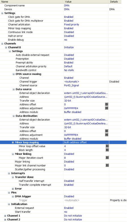

2.1)  I configured the "Init_eDMA" componet by Processor Expert to do so. There are only 8 transfers to make the debuggind easier and make sure it works. The real project would have 4000 transfers aprox.
2.2) This transfers are controlled by the DMA hardware of the microcontroller. I configured it by Processor Expert.
2.2) I am not sure to undestand when you ask what is triggering the DMA transfers. The eDMA peripheral request is hardware request: GPIO pin PTD5 makes a request on its rising edge, that is generated by PWM.
3) OK, I see. So you mean that by the time the "Major loop finished" interrupt is executed and PWM is disabled on it, some extra PWM pulses are generated. That makes sense. However, why sometimes I see 8 pulses (target pulses) and 9 and 16 in others?
4) Mechanical bouncing is discarded. I control it by software.
I agree when you say that I need to control the HW directly via DMA and avoid interrupt routines being involved. However I see necesary to use the "Major loop finished" interrupt to be noticed that it is finished. Don´t you think so? And if not, how could I do it?

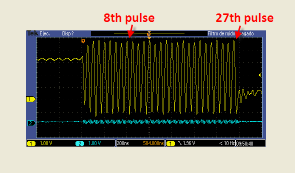

Hi Mark,
I followed your advice and I succeded stopping PWM by transfering 0 to FTM0_SC through DMA. So what I see know is that PWM stops when the 8 transfers are finished. Great :smileyhappy: !!!!
However, I need the PWM to work at a period of 50ns aprox, and at this frecuency what I see is that the PWM stops after 27 pulses instead of at 8.
Does it mean that DMA can´t work so fast? Any clue to make it faster?
Thank you.
