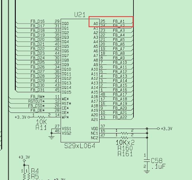

I am still confused.  Please compare the discussion in K22 Flexbus and External SRAM and Flexbus - Help Needed .  The two discussions differ on the use of A0.
I have attached my schematic which hasn't gone to prototype yet.  Can someone verify that is correct as far as the hardware is concerned?  And if it is correct, can Freescale please add it to their appnote?

Hi Mike,
To add my two pence, my version using A0 to FB_AD0 now works absolutely fine once I'd sorted my FB_BExx signals out.
I was more than confused when trying to figure out whether my pin mapping was correct. To be fair, I still am.
At least I now have working SRAM and LCD on the same flexbus.
Kind regards,
Kevin

michaelhuslig
I think using FB_AD0 is definitely the problem.  Aligned 16 and 32 bit writes and reads appear ok because FB_AD0 will be 0.  To see the problem with 8-bit writes, you have to write different data to each byte.  I am suspecting that if you configure the FB_AD0 pin to be a GP output, your byte writes will begin working at odd addresses, but you will only be using half of your SRAM.  Rewiring the AD0 pin of the SRAM to the next highest unused FB_ADn pin should give you full access to the SRAM.

Hui_Ma
Hi Michael,
I think your Flexbus connection is correct.
Please check your Flexbus configuration, the FB_CSCR0[PS] bits should select the 16-bit port size.
For Kinetis Flexbus original from ColdFire Flexbus module, I attached ColdFire Flexbus connection for your reference:
Wish it helps.
Ma Hui

DavidS
Hi Michael,
The AN4393 is using the FlexBus in a method to use 8-bit Data interface from Kinetis to a 16-bit interface on the MRAM.  Therefore they are not using the A0 for normal SRAM interface implementation and also not using Byte Strobes (FB_BEn).
For the second FlexBus interface in the AN4393 to an LCD, they are not using the A0 because they will always pass 16-bit information to the LCD and not bytes or misaligned longwords.
EDITed/Updated:
For your SRAM FlexBus interface you want to use FB_AD1 to the SRAM A0.
This is becasue the Cypress SRAM is a 16-bit/word addressable memory and the FB_AD0 is not needed.  The FB_BEn signals will let the SRAM know which byte lane to write or read for byte access and both will be enabled for word access.
