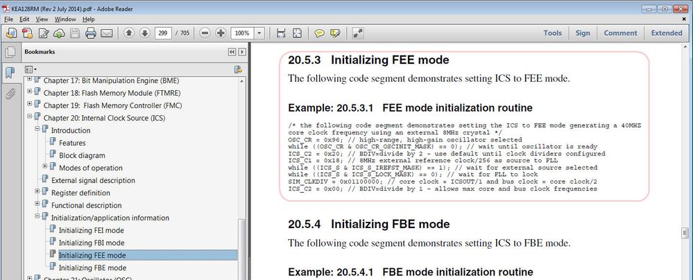

Hi VIGNESH,
Please refer the "Example: 20.5.3.1 FEE mode initialization routine" in KEA128RM.

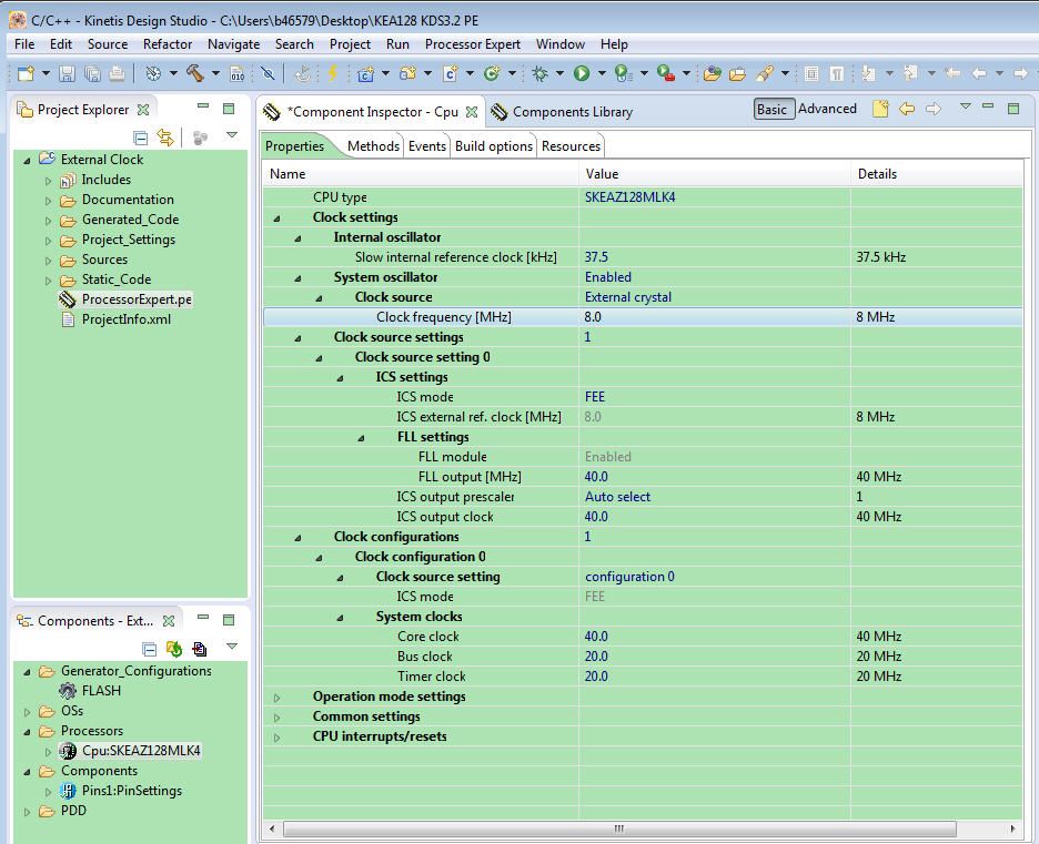

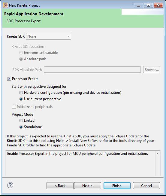

You can also create a Processor Expert Project by using the KDS3.2 .
The Processor Expert will help you configure the setting.

vigneshbalaji
Senior Contributor I
    This mode Explains to use External Clock as Internal Clock Reference.
Can you Explain me how to select the External Clock directly as the Bus Clock Out????
2,290 Views
Robin_Shen
Hi VIGNESH,
If you want to select the External Clock directly as the Bus Clock, please select FBE or FBELP as ICS mode.
Robin
