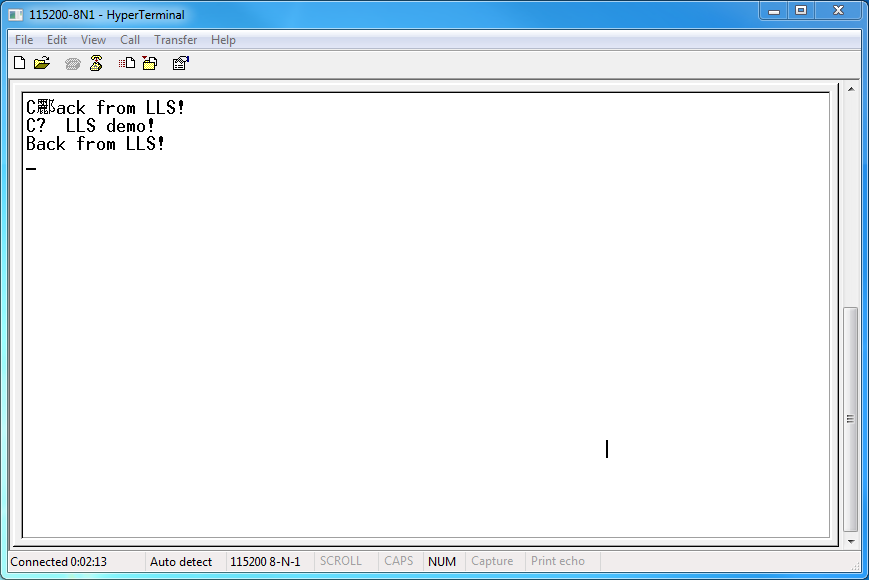

Kan_Li
Hi Javer Valino,
I have implemented a TSI LLS demo based on FRDM-KL26Z, please kindly refer to the following for details. The project is also attached. Please also note only TSI0 CH0 and CH14 can be used as LLWU pin, and in my demo, CH0 is used and any edge is set as the wake up event, you may change it according to your application.
Hope that helps,
Kan

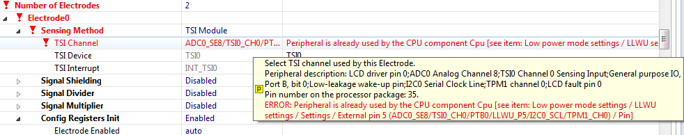

javervalino
Hi Kan,
Good day!
I already tested your example and it works, but unfortunately another problem arise in our hardware setup. We found out that when you use TSI0_CH0 in external pin 1 in   LLWU settings, you cannot use it as electrode in TSS_library component.
Please see below image.
Can it be solved by using the internal module 4 (TSI0) instead? Can you give an example for this.
Thank you Kan for your usual support.
7,078 Views
Kan_Li
Hi Javer,
I just implemented LLS demo waked up by TSI module instead, please kindly refer to the attachment for details.
Hope that helps,
Kan

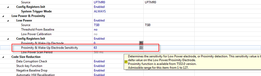

javervalino
Hi Kan,
Thank you very much. This is really what I need.  The last problem is the sensitivity of the wakeup electrode during lls mode. In our design we use a top cover plastic about 1mm in thickness and it work nice during normal mode. Where can I edit the sensitivity of this wakeup electrode?
Thank you for the usual support.
Javer
7,078 Views
Kan_Li
Hi Javer,
I think you may change the option circled as below:
Hope that helps,
Kan
