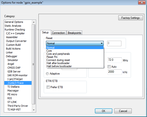

Hello Guys,
I am Using MKM34Z128ACLL5 and IAR Workbench version 7.20 while debugging I am Getting this Error  EXECUTION FAILURE IN FLASH LOADER.what is the reason for this error and its cause.
2,378 Views
jorge_a_vazquez
Hi Bharth Yalla
What debug interface are you using? This problem normally is related with the reset pin of your debugger, so please check this pin in your device. Also you could try to check your reset option in Project->Options->Debugger->(your debugger interface) and try to select the option that you need. For example for jlink.
Hope this could helps.
